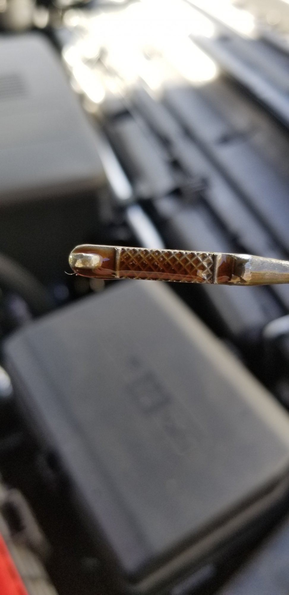

Guys, is this normal for 2000 miles driven since oil change? The crosshatch was covered after oil change.
I will add, that she wasnt sitting totally level, the front end may have been up just a tad.
You’ll start chasing your tail checking your oil. Check it in the same spot at the same engine temp. Best cold if you can. Otherwise as long it’s in the safe zone you’re good.
Lol, no joke man.
I just parked hee on a level spot. She hadn't been run for a couple days. I'll check again in the a.m. to be sure.
Thank you for the 411
Lol, no joke man.
I’ve been there, believe me. I sometimes forget I live on a hill. I’ve had some oh sh$t moments. Then I remember.
Lol, good deal. Thanx again man :)
Wow! What a difference just the least bit of unlevel land can make when checking your oil!
I parked her totally level last night, and just checked again, and shes pretty much full, lol
Man, and I mean before, most would think she was parked level. But, she really needs to be level to get a correct reading
Here is the pic from just a minute ago
Basically full
