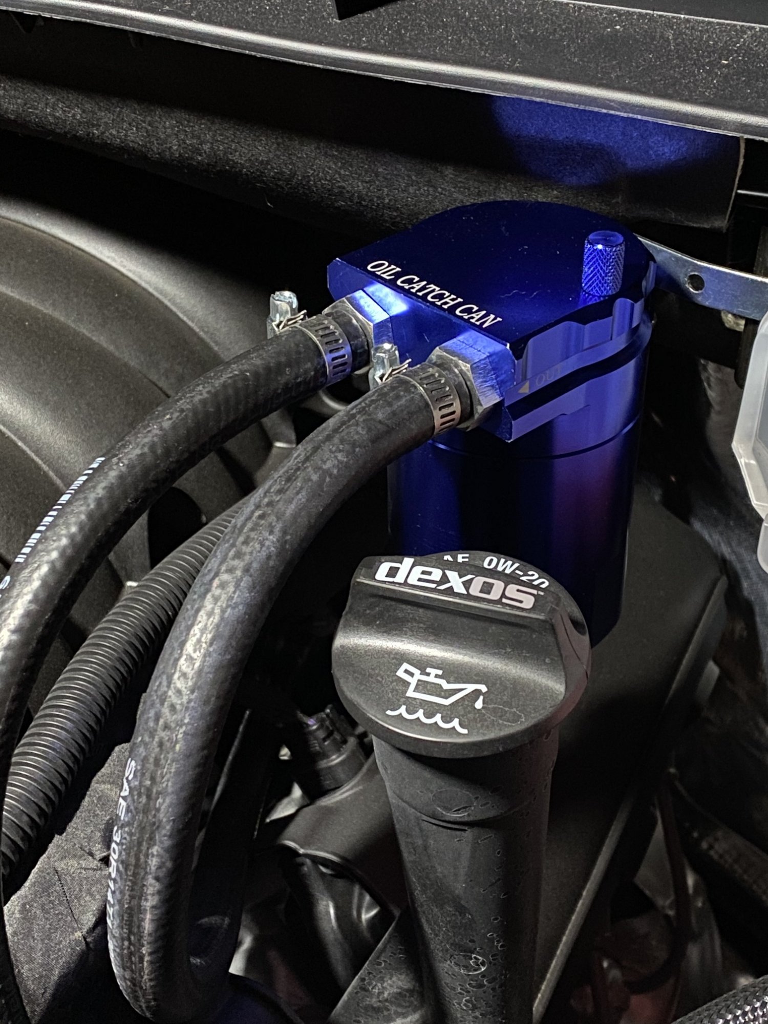

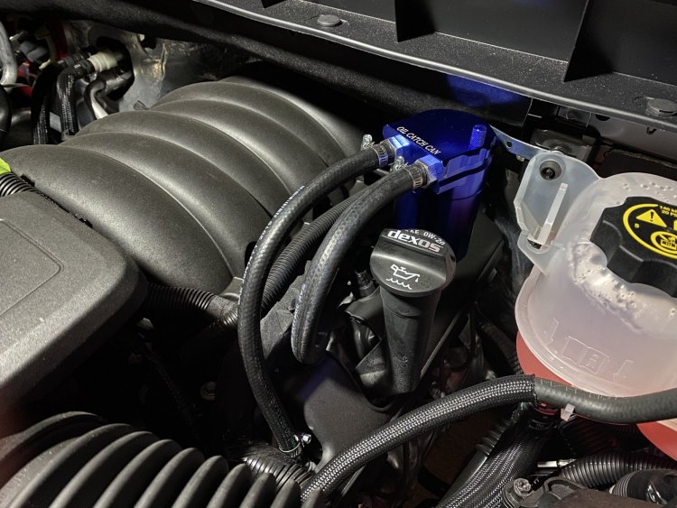

On 12/19/2019 at 7:45 AM, SquireSCA said:
Install was easy.  Mounted it right up with an L bracket from Home Depot and a lock-nut to that mounting screw for the washer fluid reservoir...
Connected the two hoses, done.
I did make sure to unscrew the internal filter that the "in" line with the oily mist flows through, and filled it with steel wool... this "filter" forces the hot oily air to breath through that, and very effectively separates out the oil before the vacuum line draws that air into the manifold.  Those droplets form inside that inner filter, and then drip into the bottom of the can...
Here it all is, installed.
That’s a sweet looking setup. Will be using the exact one. The name brand ones are way to expensive for a Chinese catch can with hose and plastic fittings if you ask me. I’ve seen those catch cans on eBay for about 20 dollars. I’ll run over to Home Depot and look for the bracket. You screw the HD bracket directly to the catch can with the provided screws? And did you have to drill holes on the bracket? Better pics would be appreciated.
