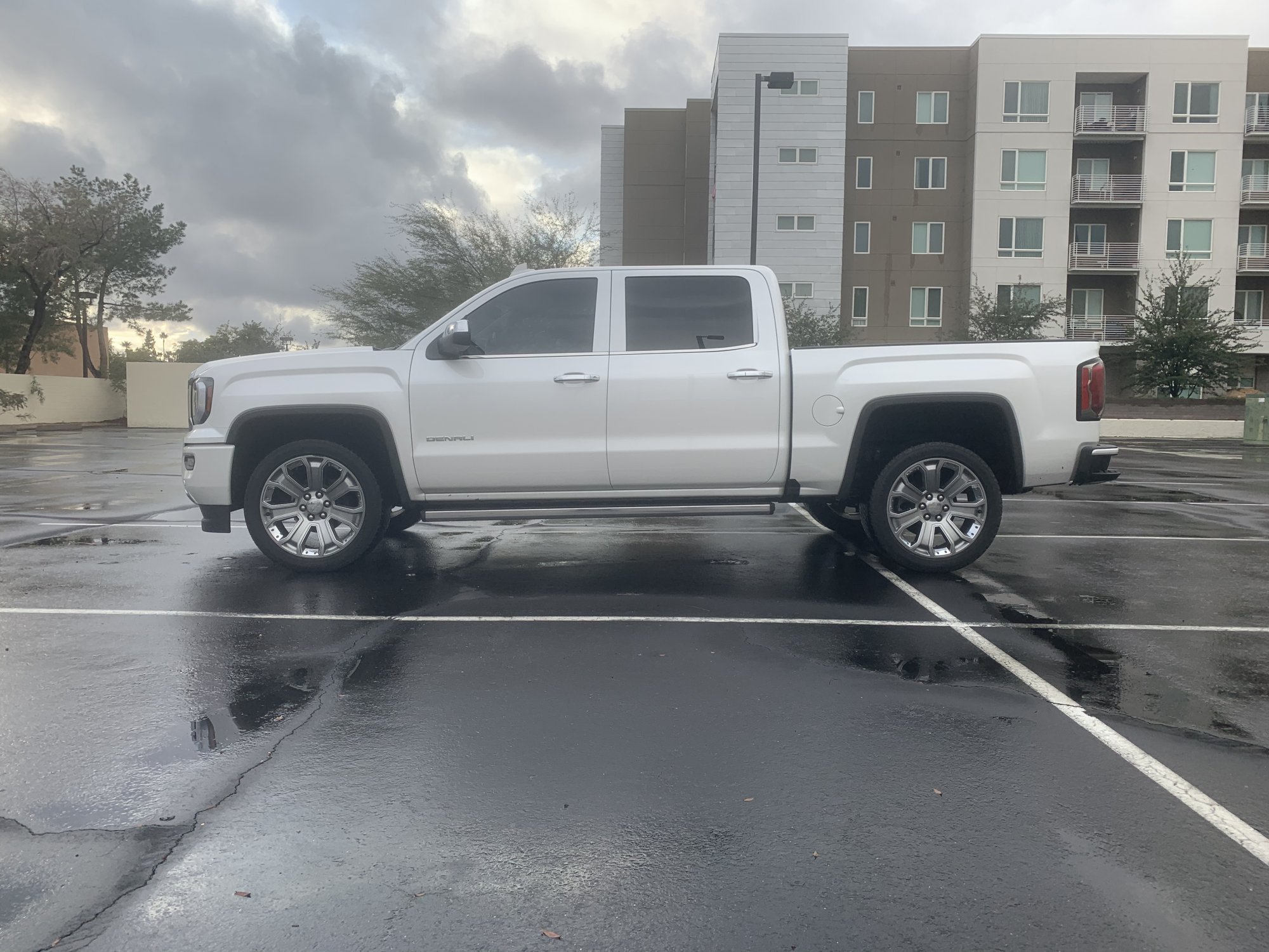

I recently picked up a 2018 Sierra Denali 6.2 4x4. It had 23k miles. Appears to be 100% stock.
My question is what is the factory rake supposed to be?  My rear is a little over 4” higher then the front. It don’t seem normal to me and I want to level it but I have no idea how to since the big difference. It has the magneride. I don’t know if the previous owner did something to raise the rear that much or if this is normal for these. I’m used to seeing a 2-2.5” rake. Not this much. Any help would be appreciated.

Post a picture
Yeah that doesnt look right
Can you post the measurement from top of tire to bottom of wheel well, get one for front and for back, should be able to tell you which side is “off” then so you can inspect.

pick one and I’ll reference mine. Denali should have same ride height from any other truck, just the shocks are different
I did the top of tire to bottom of wheel well.
front 5”
rear 9”
Ok I’m in for the night. Prolly do it tomorrow. If somebody else sees this and has factory ride height on the same wheelbase feel free to do it for me.
Post a picture of the rear block under the leaf spring and the rear shackle at the rear of the leaf spring that connects to the bracket on the frame.
Someone could have installed a rear lift block or lift shackle to raise the rear end up higher.

I’ll get those tomorrow during the day. I did look at them and they look stock.

What the?!
I measured driver side also. On factory 22” wheels if that matters.
I don’t understand why mine is so high.
