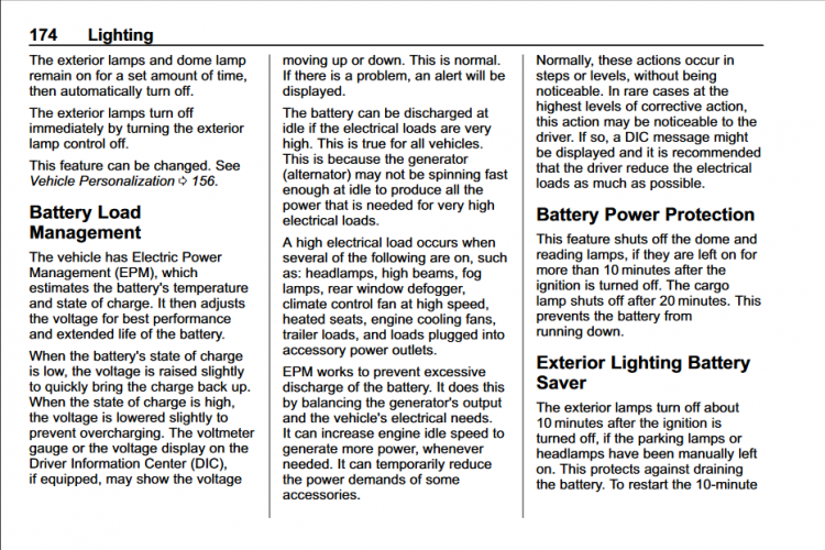

I sure wish these vehicle manufacturers would print some kind of book or pamphlet describing the systems and features of the vehicle...sort of like an owner's manual or something like that
Oh, wait a sec...
Screenshot_2020-01-12 2020 GMC Sierra Sierra Denali Owners Manual - 2020-gmc-sierra-owners-manual pdf.png
It doesn't sound exactly like what you're seeing, especially since you used a meter, but there's a service update; BULLETIN N192267870: BATTERY SAVING NOTIFICATION.
Basically, the computer thinks the battery is low and informs the drive (via text and email too). But since you used a meter, it might now help, unless the alternator stop charging? Not sure.
Anyway, it might be worth taking your vehicle to the dealer and having them do the update.
