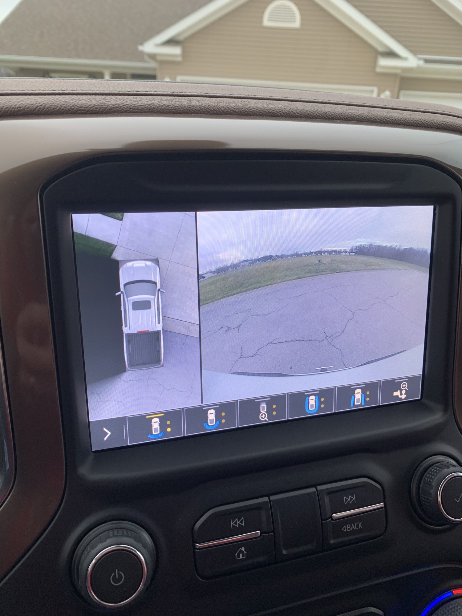

2019 Silverado High Country with Technology Package. The drivers side mirror occasionally flickers or is completely black. I occasionally get the blue screen of “Service Rear Vision System” also. Dealer has already replaced the camera, done every software update/module reset possible, and now wants to replace the cable that goes from mirror, under dash, to behind rear seat (so essentially take the entire cabin out) based on their communication with GM. It’s my personal feelings they don’t know how to fix it. I’ve attached some pictures. Anyone else had this issue?

I'm having the same issue you described. Same as the pic you posted with the entire drivers side view blacked out. Truck is brand new and has been this way since delivery.
I get the same thing on my '19 AT4 as your first picture about half the time. Put it in reverse, no picture from the driver side mirror cam, followed by 2 seconds of blue screen when shifting back to drive.  Started at about 6000 miles.  Haven't had it in to get looked at yet.
