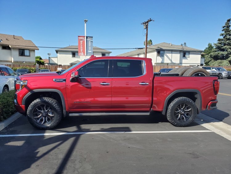

I just had my Denali leveled with the suspensionmaxx kit. 2.5 front and 1.5 rear. Its pretty level now with this setup. I think if you were to go 2 in the front without the rear being moved up at least 1 inch, the front will look raised a bit. Here is a pic of mine for reference.

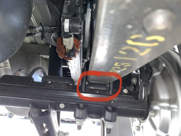

Your's came with a block? Mine did not have one. Blocks are usually true to size. You will need longer u- bolts.
I thought the steel piece under the leafs in this pic is a removable block, but I could be wrong as I haven’t torn it apart yet.
Thanks, that’s exactly my concern. Anyone know of a good 1/2inch or 1inch block that will work with the Denali ARC? I can’t go as high as you due to my garage door height and work parking garage limitations, but do think I’ll end up wanting to lift the rear just a hair once I level the front by 2”. We will see once in install it.
Mine is similar to this. I have a 2" front and 1-1/4" rear. So theoretically  I have 3/4" more rake.
