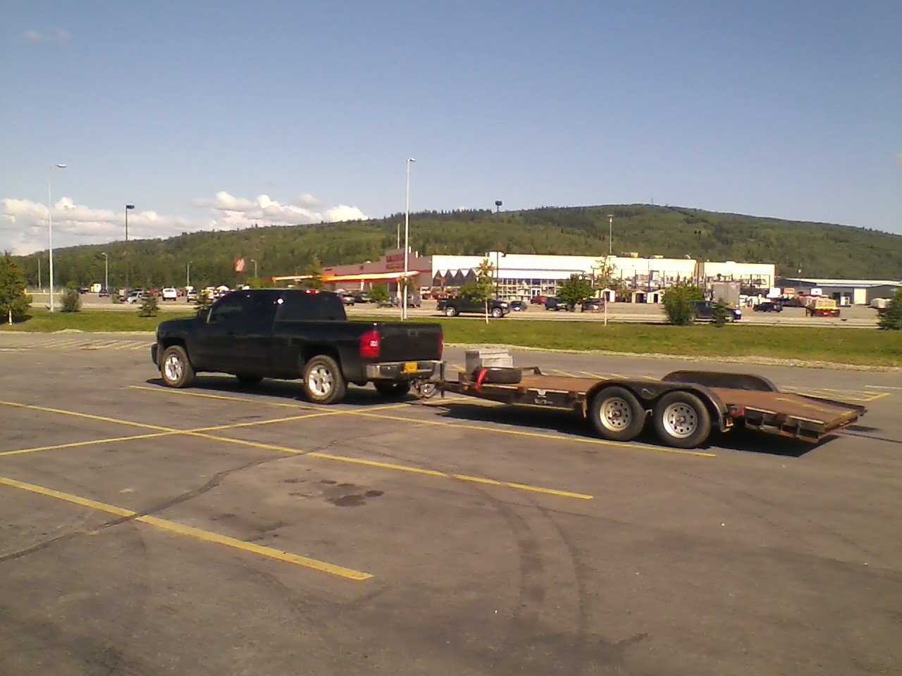

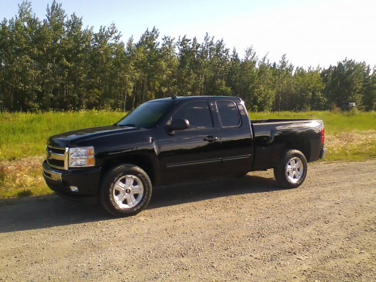

The 3m chip guard film and Xpel film are essentially the same thing. They are a clear film that sticks on to the vehicle and protects the paint/clear from chipping, the newest stuff is pretty robust and should outlast 5-7 years I would think. I would do this anywhere that faces forward... installers can make specific recommendations based on their experience but painted bumpers and grilles, fronts of hoods, A pillars, mirror caps, and rocker panels are pretty typical... basically where ever your budget will take you.
The ceramic coating is an extra step, once again where your budget will take you... this lasts 3-10 year depending on the installer's package, the prep work, and the number of coats. The product itself isn't terribly expensive but the application can be a challenge so the packages typically aren't cheap... They do typically include a decontamination and buff which on a new black truck will make it look amazing. It also wicks moisture away easily, I would just spray off my 2011 and unless it was extremely dirty all I needed to do was dry it... another note it I use a leaf blower to dry the truck so it doesn't get scratched by the drying towel.
Here's a couple pics of the truck, the top one was about at it's worse on a 400 mile round trip down a gravel road... the ceramic coating doesn't let much stick to the truck. The second was a clean shot... black looks so good when it's clean!
