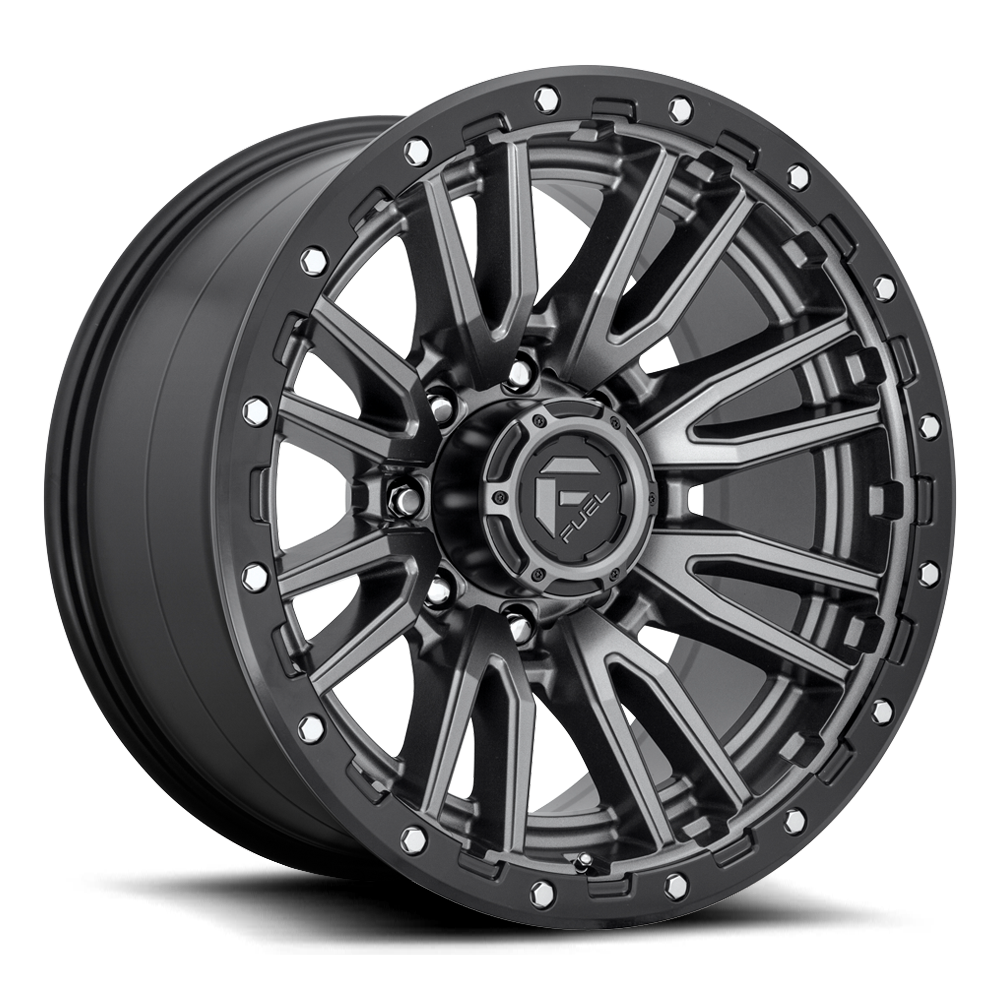

currently for me i have settled on the newly announced FUEL rebel 8 because it has exposed lugs, comes in 22 and +13mm offset on a 10" wide wheel comes out to about 6.02" backspace it's 10 inches wide so it should only stick out just over 1.5" from stock.

Don’t get those wheels.
Haha jk, I love those, I have the Bronze ones on order and should be here any day now, a week max, they’ve been on backorder for about a month.

What offset and size did you get?

22x10, -18
I don’t have tires yet but doing 35’s, F load rating. I’ll also be waiting to install them until after I do some sort of leveling kit due to the low offset. Will wait until I can do some test figments before determining which leveling kit but leaning towards 3+1.
I love that offset on a 10” wide wheel, for me it’s perfect and what I’ve had on my past trucks including my old 2019 Silverado 1500.
But yeah with those dimensions you can’t just slap them on and go.
