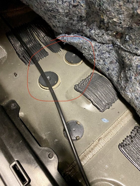

Started installing a set of amp steps last night and when I pulled the carpet back to run some wires I noted the floor was very wet. I have rubber floor mats so it’s had to say how long it has been wet.
It appears to be centered around the two large plastic caps/plugs. The cable area by the door sill is dry, it’s just the center section that’s wet. He sealant around them looks ok. I have an appt Tuesday to have the dealer look at it.

I dropped it off this morning, its raining pretty good today so hopefully that helps. Dealer says they have seen some winshields leaking and suspects that but they would put it in the wash rack and spray top and underside to try and find it.
We had two trucks with the rear window leak that caused wet floors in the front.  They were 1500s but same setup.  Have them check that rear window.
Mine goes in Saturday and it will stay until it dries out.  The leak is coming from the spoiler above the rear window.  This is a known issue.
Dealer said they found the sunroof drain tube diconnected. This allowed water to drain onto the floor pan instead of through the floor grommet. Probably pull the carpet again next good rain we get to make sure its fixed.

They said they did water tests from above and below. Based on the hard water stains all over the truck I'd say they hosed it down pretty good. Hard to say how long mine was leaking since I have the rubber floor mats. Its supposed to rain again tomorrow so I will probably pull the carpet back friday and make sure i dont have anything else leaking.
