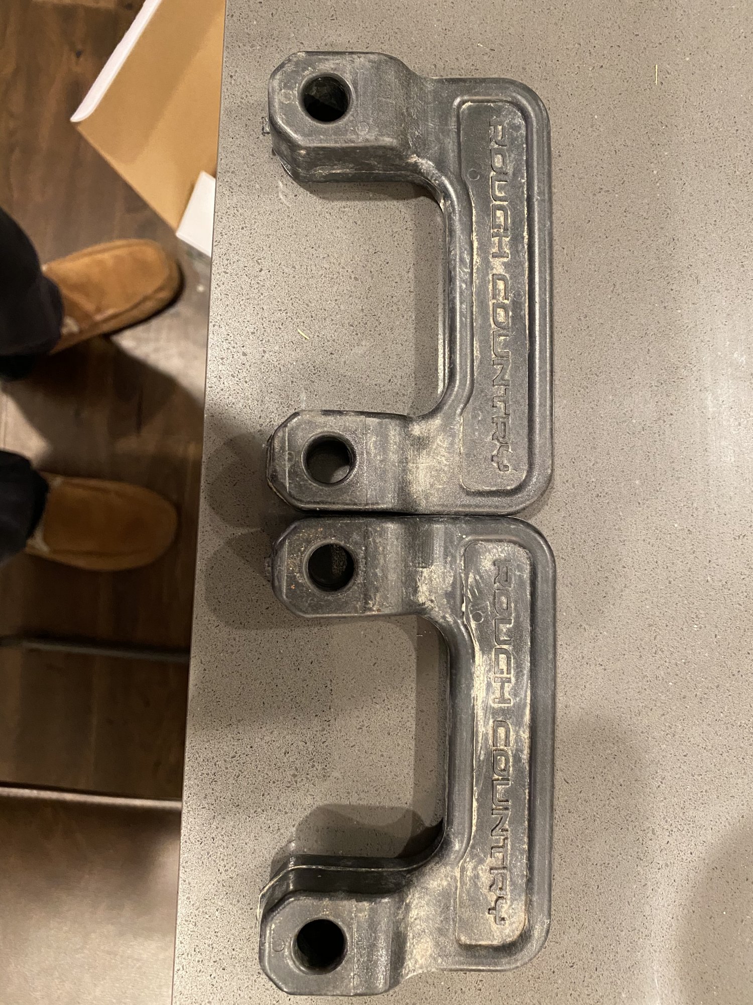

Adding 2" block lose some ride?
looking to level the front 2" with the rough country level kit, just wondering if adding that plastic piece will cause a rougher ride
11 hours ago, justin saleeby said:
Will adding a 2" level block give me a rougher ride? Ive got the AT4 thanks
I can see your question is not being answered no it will not affect the ride with a front leveling block. No since arguing over what the piece is made of just answer his question.
10 hours ago, lapoolboy said:
There is no Rough Country 2" level kit with plastic parts.
I could mistaken but pretty sure that says Rough Country? Additionally yes its made from plastic and it provides a 2” level... what else you got water boy?
Thanks for your positive contribution.
You asked about a plastic "leveling block" for an AT4 by Rough Country.  No such thing exists.  Of course, if you'd have used the correct terminology in the first place, I could have answered that question in my first post.  That lower strut spacer you pictured is not recommended on an AT4.
So you didn't answer his question because he didn't use correct terminology and you knew what he was talking about? Really man. By the way some of those are made out of composite which has the feel and look of plastic.
Just finished putting the ready lift 2 " kit on my at4    made for the at4 and trail boss with factory lift    2" in front 1 " in rear    ride stayed perfect and same.   Blocks on rear/ spacers in front     Because you are not changing any spring rates just the mount location--it will not change the ride.
Yes, really.
I wouldnt go anything over 1" but if you do don't do it without adding aftermarket upper control arms.
You might not feel the difference on the street but any sort of off roading you will notice the decrease in wheel travel.
Sent from my ONEPLUS A6013 using Tapatalk
In my experience it does stiffen the ride a little, but not much.  Next would be that those spacers are not intended to be used on the AT4/TB, they make a kit specifically for your truck.
The one that seems to work with the TB/AT4 is Motofab. They have a part specifically for the trucks but not sure what the difference is from others since it literally looks the same.
