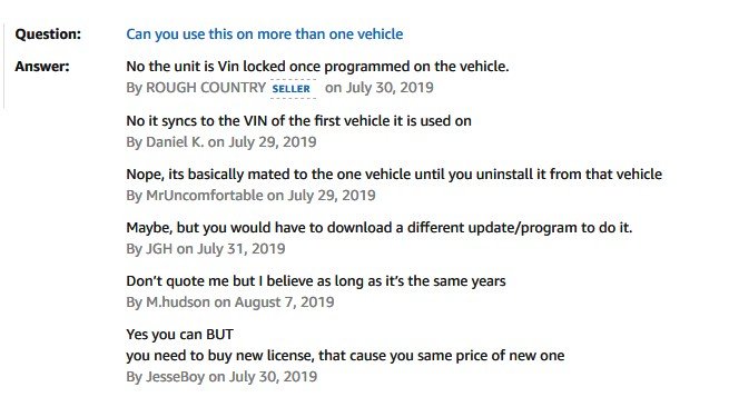

I found two of these units on FB marketplace.  One was $70 and one was $100.  The clue was a comment on one that said " Used but removed and unlocked ", so I did some investigation.  The best information I have been able to find was on Amazon Questions:
Looks like it will only work with one VIN.  If the cost to buy a new license is the same as a new unit, then it won't be any good to buy a used one.  *sigh*.  Looks like I'm in this for $140 or nothing.

OK, PSA:
From what I know once it has been uninstalled/unlocked from a vehicle it can be added to a new one. You can’t have more than one at a time.

I bought a used Hypertech that was used but unlocked and it worked fine. Got it for $70. The original user must plug it back in to their vehicle and set their vehicle back to stock programming. That unlocks the device.
