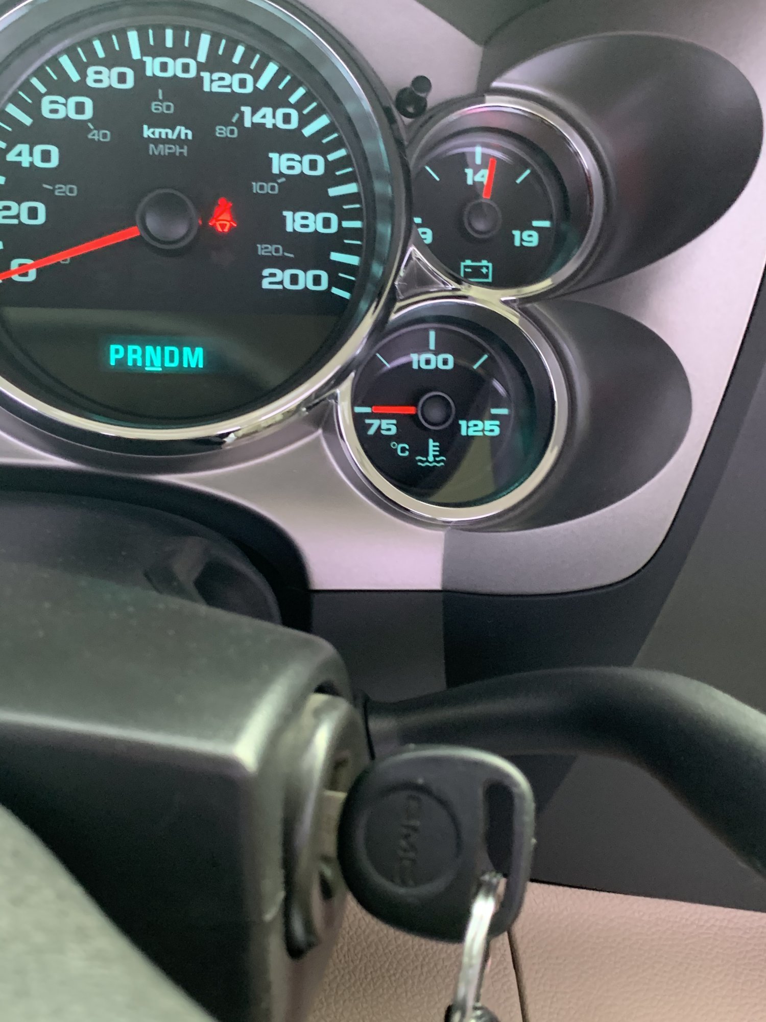

Hi
my coolant temperature gauge some times drops down suddenly and after few minutes it works ok.
could it be from the temperature sensor?  Or any suggestions
x2,Mine went haywire a couple years ago.Found the temp sensor seemed tarnished? so cleaned with soft wire wheel on bench grinder changed fluid, thermostat at that time too.Been fine ever since.
