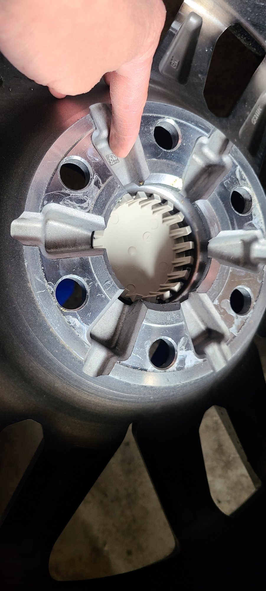

Here is the back side. Looks like there is a pocket but unsure if they line up/ have room for a small portion of a spacer stud that will work like on the trail boss wheels
Thanks Dram! Do you have the Elevation wheels yourself?

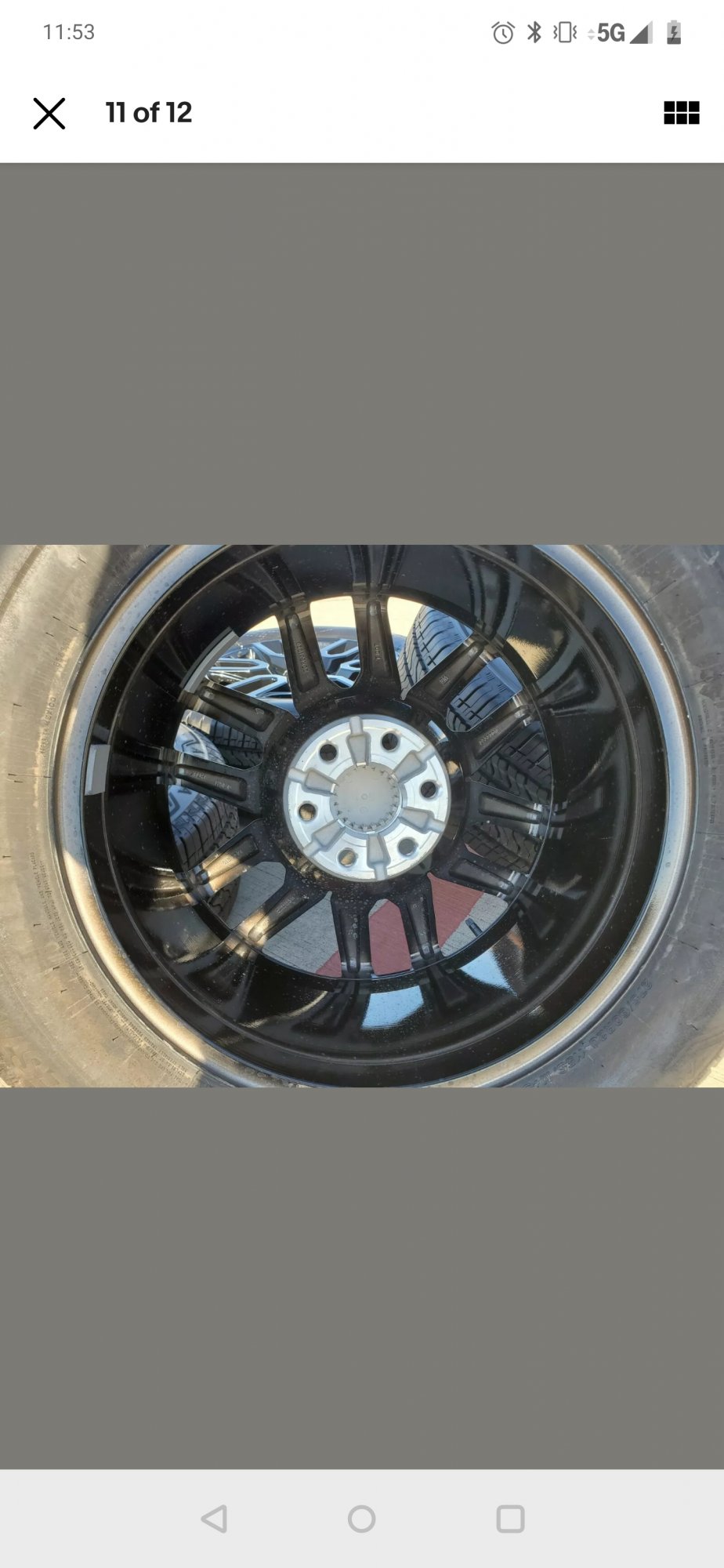

I attached a pic from Taz56 who put 1.5 inch spacers on his Sierra. From your pic it looks like the stock studs would line up. I can' t tell from the pic you attached, but do you think the pockets are deep enough based on the picture from Taz56?
I do have the same wheels. I think the pocket is deep enough but the outer portion where it narrows down looks like it will be close it helps that the stock studs taper/round off on the end. Hard to tell without just trying it. I might do the same if they do work

Hey guys, thought that I would post a picture of the backside of the 20 inch Elevation wheels for future reference. Looks to be quite a bit of room. Should easily clear 1.5 inch spacers.
