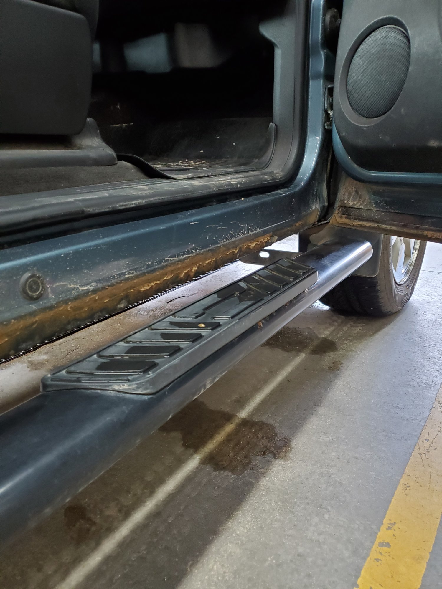

I have noticed, since moving out to the country dirt roads, that the inside of my truck is collecting mud and dirt on the inside of the door at the bottom. I have included pictures. Anyone ever have this problem and what can I do to prevent this. I do have mudguards on the front. Thanks in advance for the replies and suggestions
Looks like you are missing the lower door seal?
Looks like the rear seal is missing but the front is there.
The bottom of the door is very open there, no much you can do about some of that. You could try some weather stripping along the bottom of the body there to stop some of that stuff from coming up. That is a known rust spot because of those seals and the way the body/door is designed. The bottoms of the doors rust out because water and debris get inside the door and start to rust behind that seem sealer on the bottom of the door.
