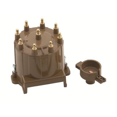

I had a 96 Silverado that exhibited the same symptoms after replacing the plugs, cap and rotor. I tested everything I could, and then finally, in frustration, took it to a factory trained Chevy mechanic.
When I explained all the things I'd replaced and tested, he asked me what brand cap and rotor I had used. I told him I'd bought a reputable brand (don't recall which one now) cap and rotor fro the local parts store. He told me to go to the dealer and buy a factory OEM set and install it. I did as he instructed, and my hard start problems went away instantly.
He told me that it is very common for aftermarket ignition parts to cause starting probems with that engine. Since then, I've talked to several other mechanics that confirmed what he told me.
I can't explain it, but I know that it worked for me.
I used only Accel caps and rotors on my 93 5.7.
Copper contacts instead of aluminum.
4
$35.
Lasted longer than the aluminum and better conductivity IMO.

oldguy96 - All the parts are either ACDELCO GM original equipment or ACDELCO professional series except the Champion 9404 Iridium. I have had good results with these brands. I hadn't thought about the cap and rotor. I will take off and inspect the cap. I will be looking at the van again this morning.

Hmm,try disconnecting c.t.s,that will take it full rich,if no improvement,go back to ignition,weak connection on coil?and as mentioned,a cheap distributor cap can cause problems,what about,use a spare spark plug and look for blue spark
