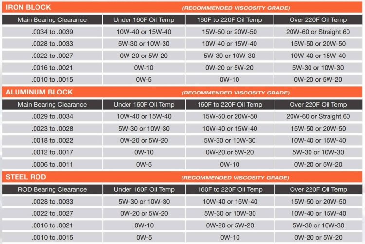

For clarification I generally agree with what I think 🤔 Grumpy is attempting to say…. where we diverge is that adding dynamic viscosity under temp and load that’s not required is needless. Could hold needless heat.
Here’s what Grumpy and I have done alike. We use a lubricant and analyze it like On the reel does.  I use the lowest safe viscosity I can that shows low wear and stable temps.

The Mitsubishi Mirage 1.3 3 cylinder gasoline engine Grumpy mentioned is the one using a myriad of recommended oils in different markets. It’s also a lead main bearing engine, multiport  etc.  Older design to be durable.

No disputing the rest on your list are mostly bad. But I don’t think they spec a wide vis range for the Mitsubishi solely because of the low quality products in some countries. Especially not when Grump is referencing the book from the UK where that is not a concern. Also don’t think that motor’s relatively primitive design is a huge factor. Toyota has modern DI 4 cylinders that have different grades spec’d based on location too.
