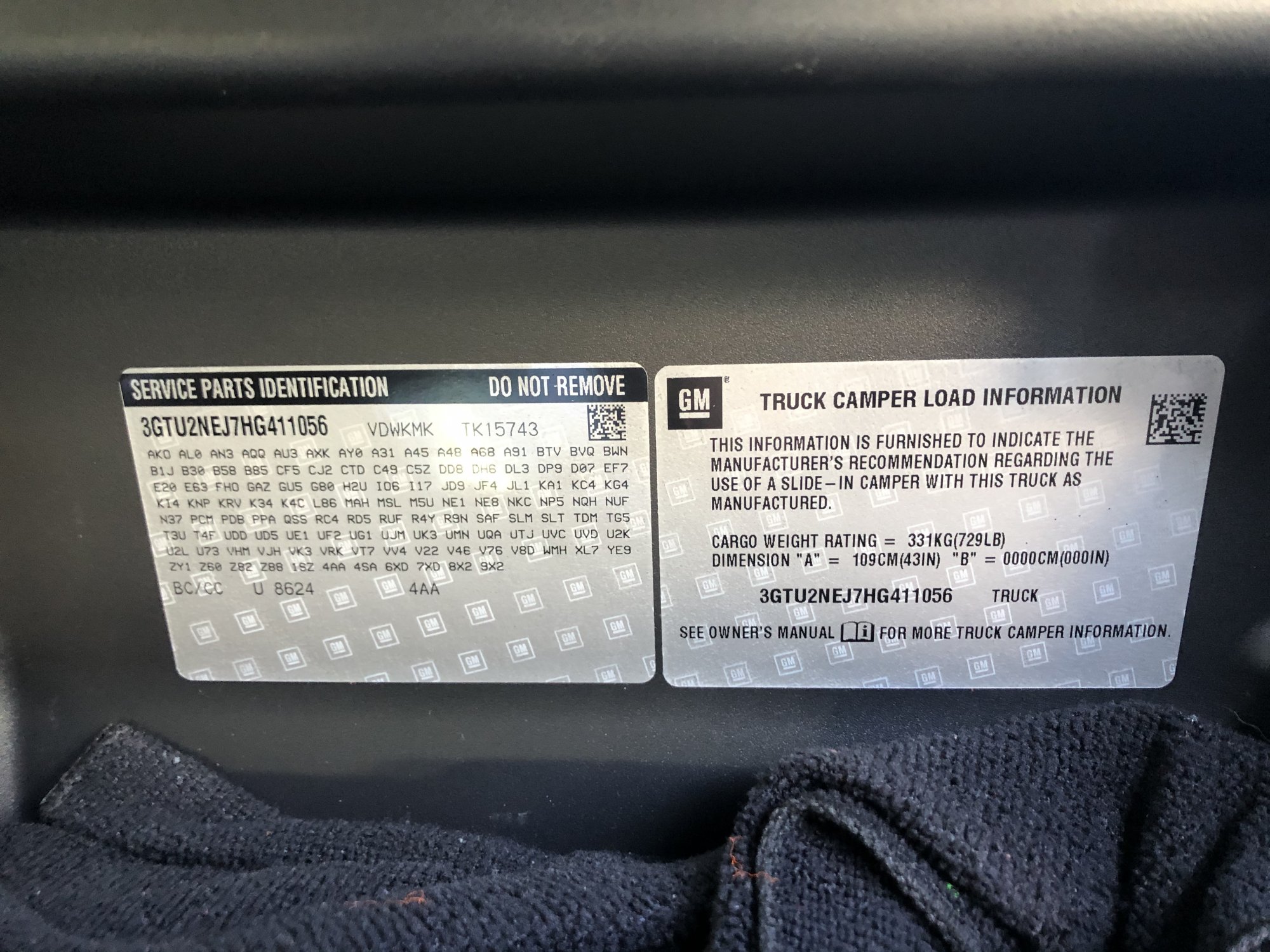

I'm not seeing which ratio it is, but there's a picture of the sticker. Once I figure out this number, what can I do with the info?

You have the GU5 code, which means the 3.23 rear end, standard with the 6.2 (no Max Tow).
You are geared for max fuel economy, with the stock set up. How does the truck feel off of the starting line, does it hold 8th gear on the freeway, or is it hunting between 7 and 8? If it is always trying to find a happy gear, you probably need to go to a 3.73 set up?
