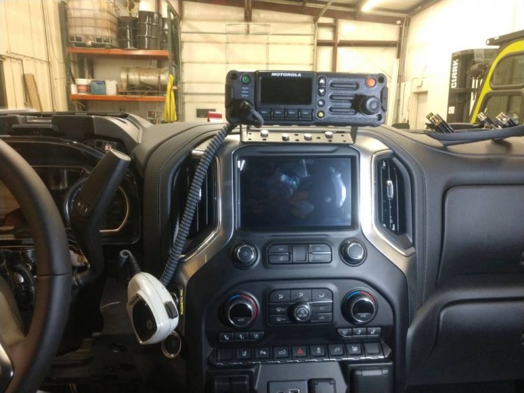

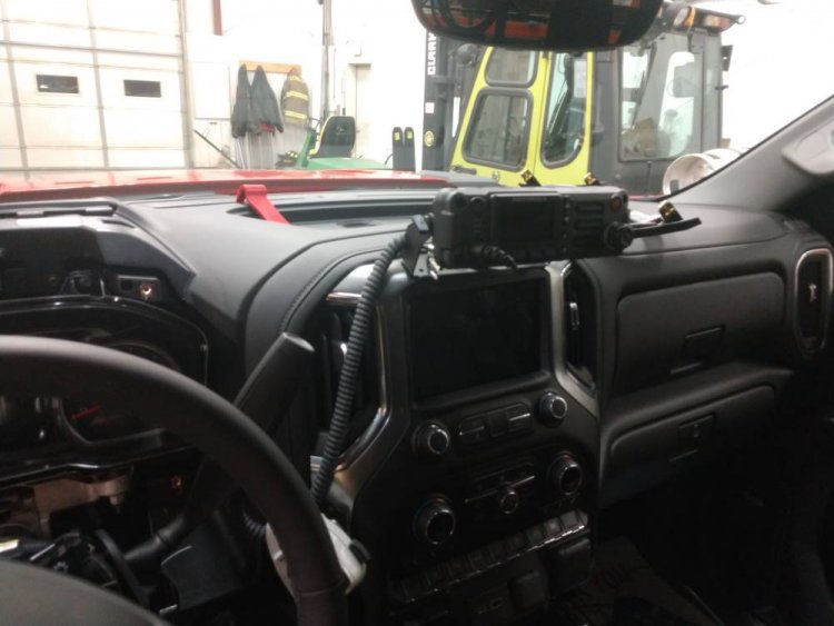

Other radio came in today
Time to drop the headliner to install antennas

Antennas installed
I only pulled the b and c pillar trim to drop the back half
I didn't pay much attention to the spoiler as I didn't have any plans to mess with it
