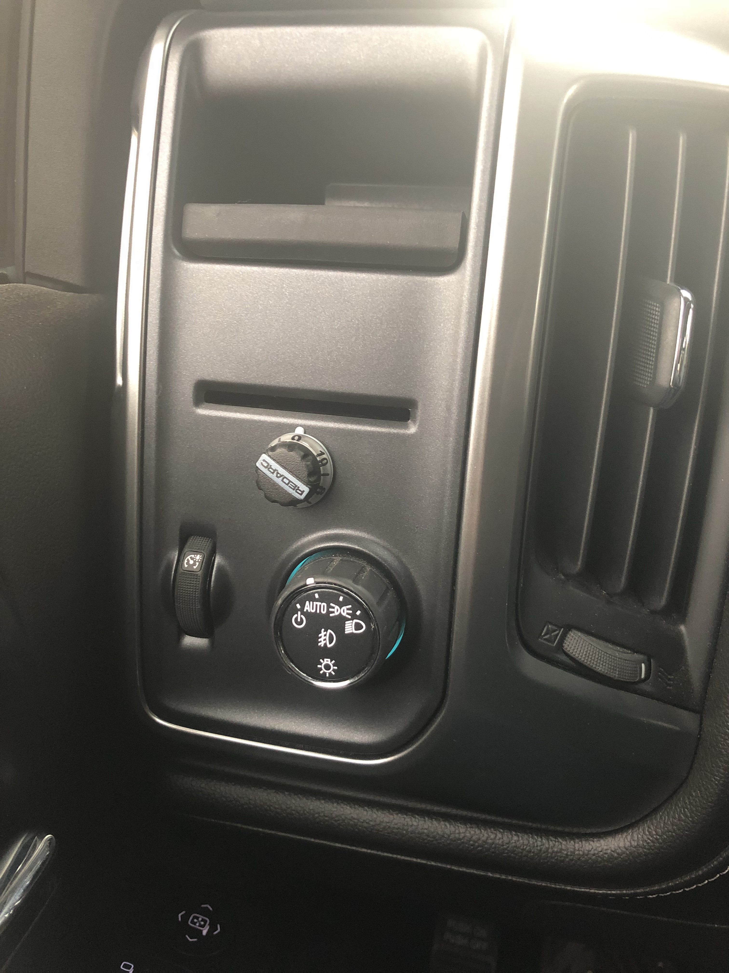

This redarc one I actually like a lot as it’s unobtrusive and the part you mount already looks like a knob in the truck. It’s proportional, with settings and a driver control mode as well as a manual button.

I’ve got the Redarc and it works great. Super unobtrusive, which is what I was going for. I spend a lot more time driving without a trailer than with one and didn’t want to be banging my knee into some box on the lower edge of the dash.

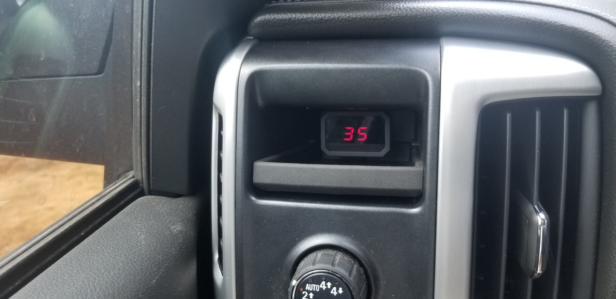

I have this one. hopkins insight it works great. I like having the display.
Mounted display in the cubby where the factory one is. And mounted the controller in the cubby next to the seat in the center console side. Easy access. The module for it is hidden in the kick panel of the console. You can get the plug and play harness for it too.
