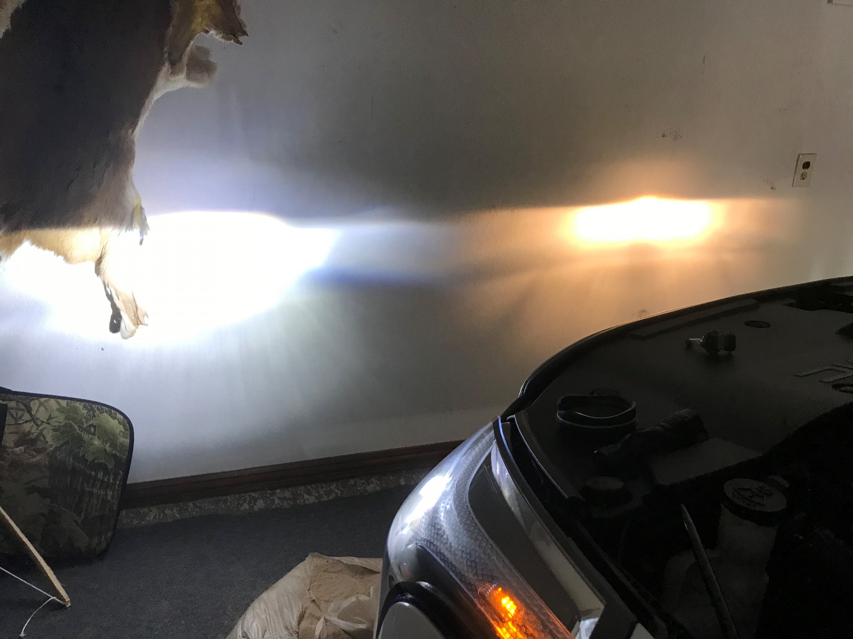

we have a 2019 Yukon (projector low beams more of a standard reflector high beam housing)...replaced both, and both are as good as my 2016 LTZ with factory LED bulbs...  the halogen bulbs were terrible...
we went with the Auxito Y13...and they are great...part of what makes an LED successful is how well does the position replicates the original halogen and how narrow is the mount/board the diodes are on...
**Edit** here are two pics...i should have taken this on the street to really show the difference, but it is pretty clear the LEDs are FAR superior to the halogens...low beam top pi (notice how it still maintains a nice clean line and high beam pics, which dont need to have the clean line...the halogen doesn't either)...
large.557395276_lowbeams.jpg.62712a39b0f0de1df17eb0ef78b7ac1e.jpglarge.276902748_highbeams.jpg.eb2fad787df853371b2f47a4137dd267.jpg
