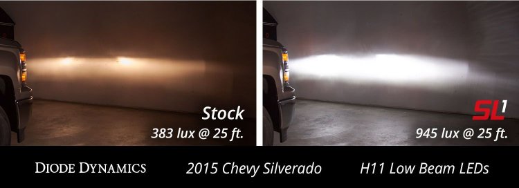

The difference is night and day.  The LED he chose is not focused and doesn’t have any “cutoff”. That’s why it has a bunch of bleeding light hanging out up top. The lux on the outside beam looks weak too. You would get the same results off $40 Auxbeams but you paid $60 more. I’m not going to sit here and argue but I am just trying to enlighten you on why they aren’t good.

Second if you watch Diode Dynamics video they talk about the LED chips being close together is better.

OK, now that we're all up to speed, it seems the race is neck-and-neck between Diode Dynamics SL1 and GTR Lighting Ultra 2. Each appear to have CANBUS/PWM built-in (still don't know for sure if that's something I need to worry about, but...) and around the same price range-ish. My questions are:
