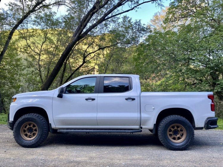

I like more tire too. 17x8 methods 0mm no spacers.

Truck looks great, do you have a leveling kit or small lift on that ?? Do you have any rubbing issues??
I have the Eibach pro truck struts and springs in the front. I have them set on the third strut perch. The rear is the TB blocks that came on the truck and the Eibach struts. I’m around 3 inches in the front and 2.5 in the rear.
I trimmed the mud flaps and removed the bracket, no zip ties though. I don’t have rubbing even on flex in the front but I’ve trimmed all the places I was rubbing before so you have to be willing to slice the liner a bit.
I have a 2020 Custom 4x4 (Not a trail boss). I added a 2.25 procomp level up front and was able to fit 35x12.5s on my stock 20’s. I did delete the flaps/air guards, but have no rubbing even at Full lock.
I had two different (reputable) 4x4 shops say something similar to me about needing a 6” lift to get to 35s. Guess it’s in their best interest to have you spend $2500 getting a Massive kit installed and selling you a tire package for another $2500. Also to be fair to them, ( at least the ones around here) they aren’t very familiar with the T1s yet
I have the tires and stance I want and am all-in for less than $1400
