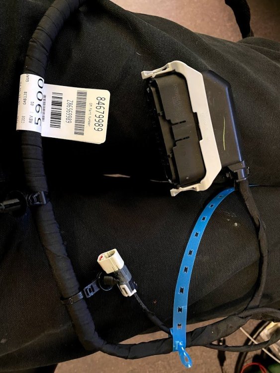

I just removed my power tailgate in prep to install a slide-in truck camper.  There are two harness that had to be disconnected under the bed.  The back-up camera harness was small, simple and easy to protect with some electrical tape.  The power tailgate and power lock harness is much larger and it is unrealistic that trying to wrap the unused harness under the bed would work.  I tried call my local Chevy parts department to see if the sell a cover for the harness but he didn't even take the time to look it up.  He said Chevy doesn't sell anything like that.  I am sure I am not the only owner running a truck without a tailgate.  Anyone have a good solution to weather protecting the unused harness?

Unfortunately, your dealer is right.  GM doesn't make a dummy plug for that connector, and if they did like some other plugs on their vehicles, they don't sell them.
You'd have to buy and alter the harness like Makito posted.
The other issues you may run into is a tailgate ajar message always on, and backup camera faults.  Not sure if it will take down the other camera circuits either.

Thanks NewDude for the feedback on the availability of Chevy dummy plug.
Thanks Makito for the info on the harness.  I think that is what I will do also.

You could also get a piece of heat shrink tubing big enough to fit over said plug and apply some heat to it so that it shrinks around the plug. Weatherproof and protected done.
The heat shrink idea is good, as is finding someone to 3d print a plug cover. I'd do it but I'm still waiting for my truck

I had no problem wrapping the large tailgate connector with two layers of plastic bag and taping it up.  You just have to get under the truck and use two hands to work the bag into place.

On 6/11/2020 at 3:12 PM, Makito said:
Just dealt with this myself I ordered this https://www.gmpartsdirect.com/oem-parts/gm-f-harness-84679989 which is a replacement harness. Just cut all the wires (making sure no wires are touching each other) and problem solved
Do you know if the plugs fit all the multipro tailgates? Dealer gave me 2 part numbers to check (neither matches yours). Said it could be either one but didn't know which, or what the difference was. Told me to look for tag on mine but it's missing. I'm thinking it's probably a matter what options the gate has and I just want to use as dummy plug while gate off.
