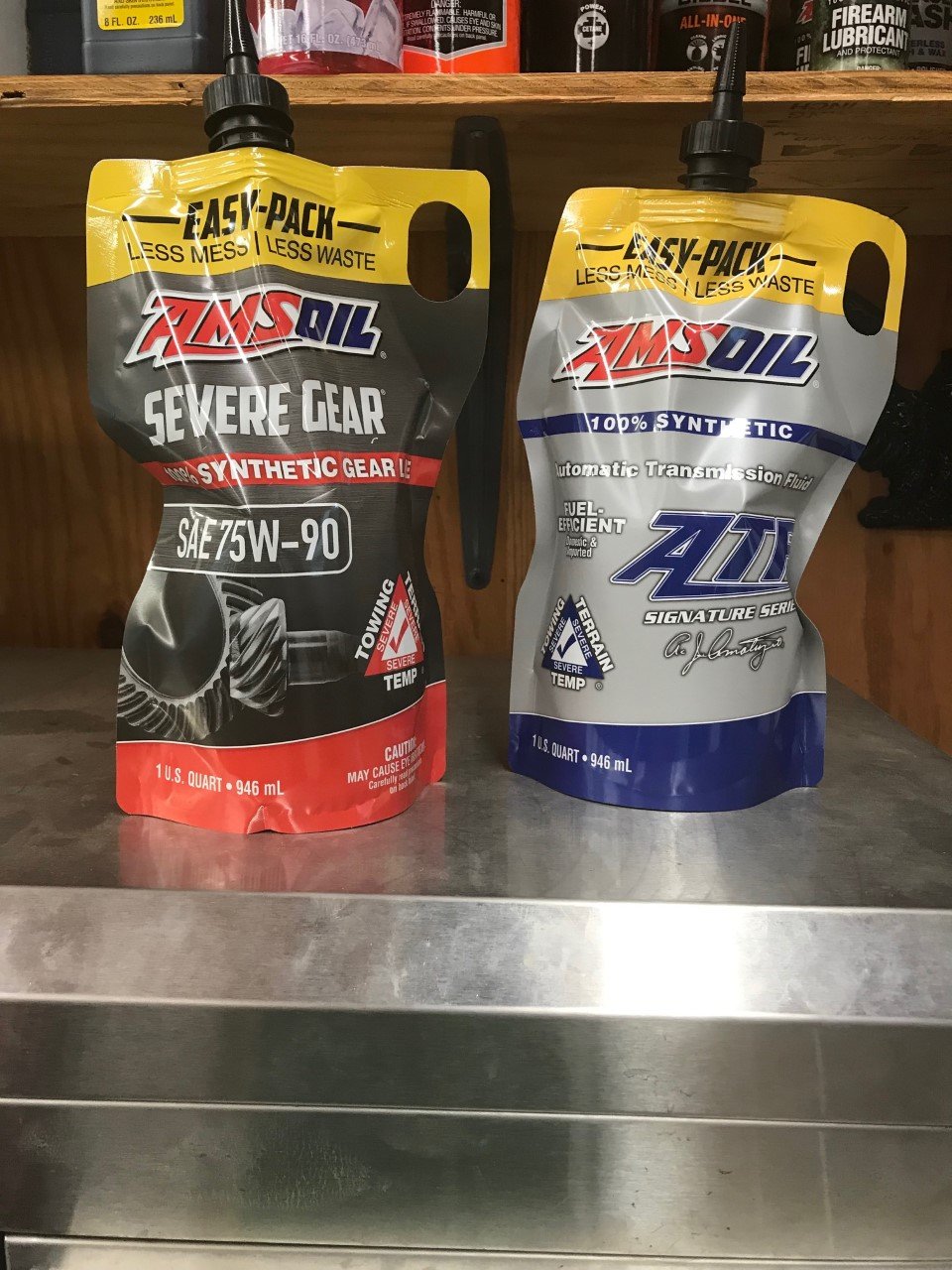

Sidenote: my garage floor looks like an Amsoil ATF murder scene.  I think I made more of a mess with the pump than without.  I will try the squeeze packs next time. ?
Mine at 24k. Yes squeeze packs are the best. Sooo easy. No mess

Another vote for squeeze packs.

I change out all my fluids within the first 10k miles.  The T case after switching over to AMSOIL I do it again at 50k.  Seems to work well for me.  The squeeze packs rock!.
