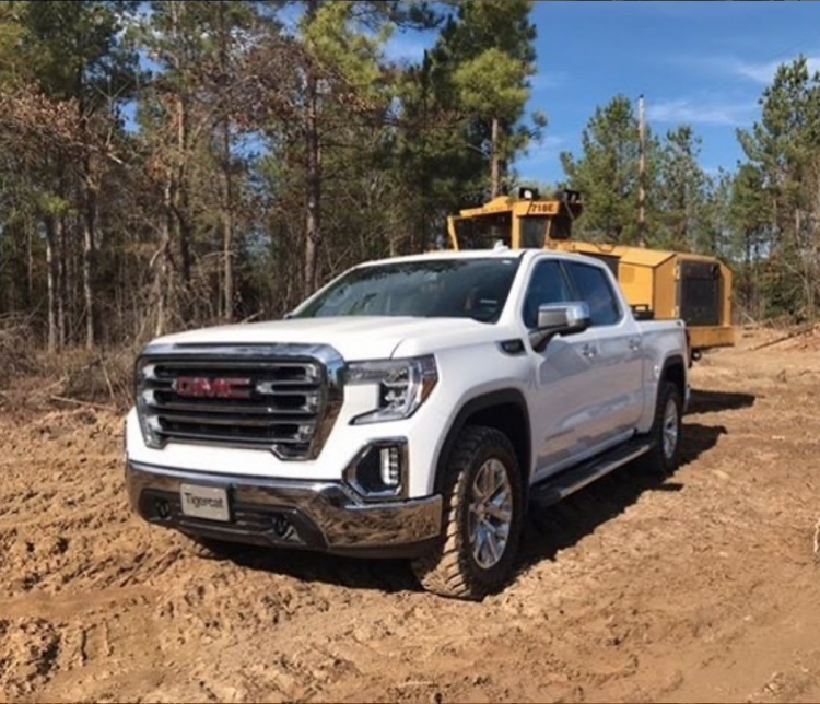

I appreciate your info on this. However, there seem to be dozens of folks here and on instagram claiming they're running 35x12.5 on the stock 20 inch wheels on a 2 inch leveled non AT4/TB truck. I was skeptical of them, until I kept finding them and personally reaching out to them to ask about spacing and rubbing the UCA.

I think you're correct. Factory UCA = no spacer. Lift UCA = spacer. I think some people are just living with it being scary close to the UCA.
I've talked to this guy, he's running a 2 inch front level on an SLT, stock 20's, and 35x12.5 Atturo Trail Blades. He swears there's no rub (fender liner or UCA) and no trimming.
