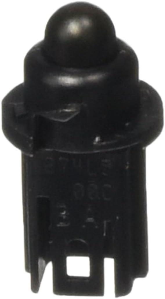

If your headlights are always on, first check is the ambient light sensor on dash. It's the common problem
As already suggested, check the little R2D2 looking dome sensor on the top of the dash.

Based on the sensors I see on the dash, there appears to be 2 of them. Do.both have to be replaced ?
It's in the center of the dash, close to the windshield. You'll need to pull the dash top off, which is relatively easy. I'm sure there are Youtube videos showing it
