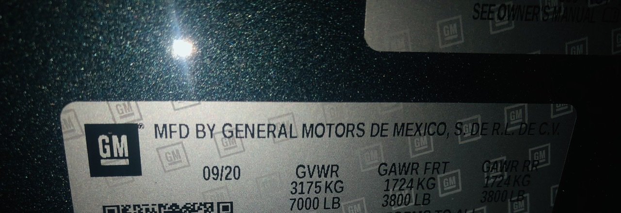

10 hours ago, Moend said:
Interestingly I only have the one sticker. They must have forgotten to put the other one at the factory.
I read that GVWR is higher than adding both front and back. Also, found that I should have weight the truck un hitched. Guees I Have to go back to the scale
Tire sticker is usually on on the side of the post facing up/front.
The vin specific towing label is usually on the same post, but on the side facing outwards, at the very bottom.
Gross Vehicle - truck and loads alone
Gross Combined - truck + trailer, and all loads
RGA - rear gross axle
Curb - truck without passengers or payload
This is from an HD, but shows the second label, from the bottom of post.
Trailering information label:
2020 AT4 2500 Towing guide door sticker | Chevy and GMC Duramax Diesel Forum
Tire labels look like:

There is a third sticker way at the bottom that has the front and rear axle gross weights.  It's the one with the QR code with the build data and the date of manufacture.
Yep mine has the 3rd sticker. 58DD380C-C0BD-4934-A5CE-6094C7B77B69.thumb.jpeg.ceb90edc0ad92fee8902c6462a32916a.jpeg
Good catch!  That's what I get for not checking mine?
And I knew about the QR label for service parts.  QR code replaces the RPO code label that used to be in the glovebox.
(this was changed/they added prior to adding the new trailering info label)
Should have put 2 and 2 together when the picture  I scooped from the 'net didn't have the QR. code....:sigh:
QR sticker will be something like this.
QR Code on Certification Label Offers More RPO Codes – TechLink
Edited by redwngr
Aha found it. And it shows 3800 front and back which is compind is more that what is my truck compined. It kind of make sense in a way the axle can handle more that what the truck at max probably away to protect against over loading an axle over the other
