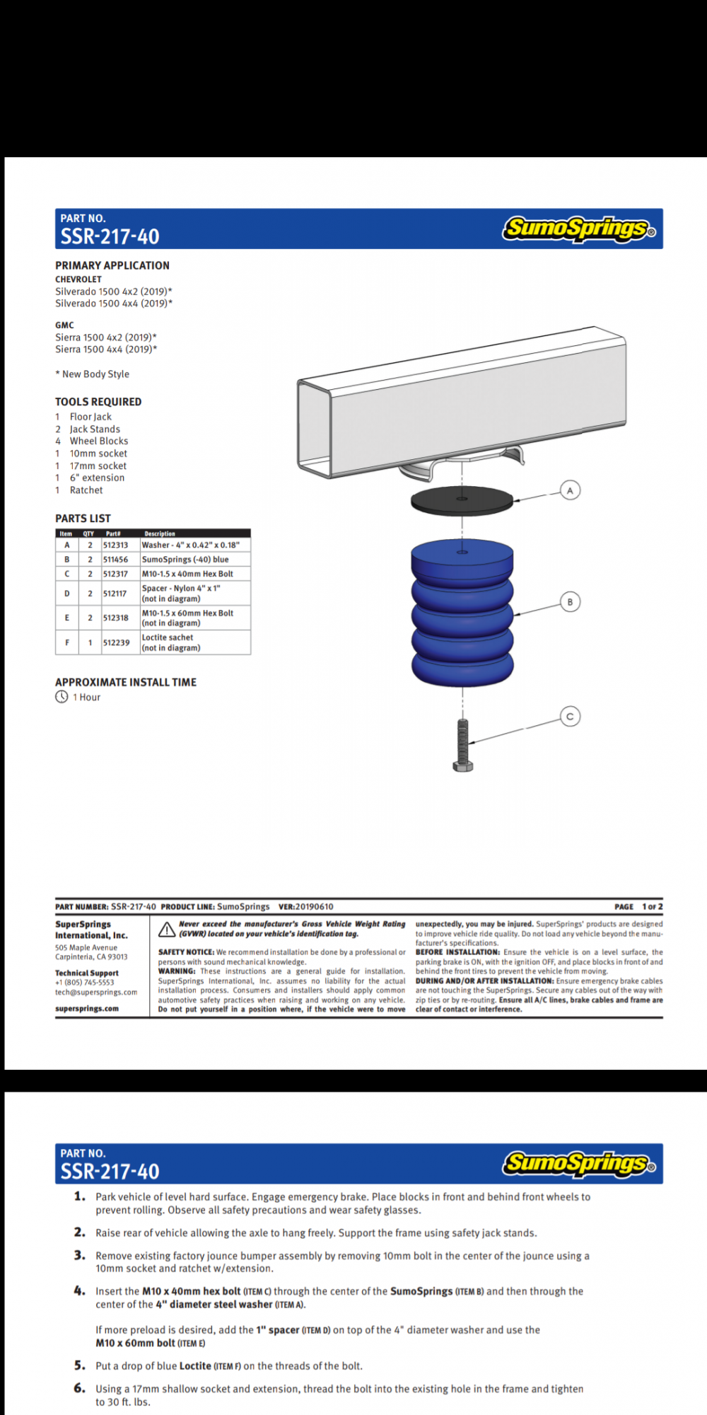

I am thinking to get the sumosprings to help with pogo stick phenomenon on rougher road. Amd in my head I imagine will help the back of the truck from going side therefore I think they might help with the sway. What are your guys thoughts? Or just get an E rated tires and call it good?
Thanks alot
I had a shop recommend the sumo springs as a "next" step, after E rated tires - I think with WDH and sway control I have what I need for loads I am hauling - up to 9,700 lbs with trailer and 2015 Z/28 inside.
D or E rated tires will be in my future as I replace the stock C rated goodyear duratrac's on my AT4 with something larger.  I would take it step by step - do one thing - see how it is - add the next piece then see how it is.  At some point if you have to keep adding you may have the wrong truck!
The 1500 series should be good to go for up to 10k with 1k in tongue weight.  For me if I were towing 9k plus all the time i would move up to 2500 diesel truck again, but for the loads I tow (4,500 - 9,700) the 1500 is fine and it offers a little nicer everyday driver when not towing than the 2500 - not to mention it is $20k less expensive!

I think you nailed on why I would want to stick to to the 1500, plus my weight is 7500 loaded which I will never run it that loaded moght run it 6500 tops. In translation only 70% of what this truck is able to tow.. thanks much buddy, I will do like you have recommended. E rated tired then the springs. If thag does not do it. I will down grade to a smaller camper.
