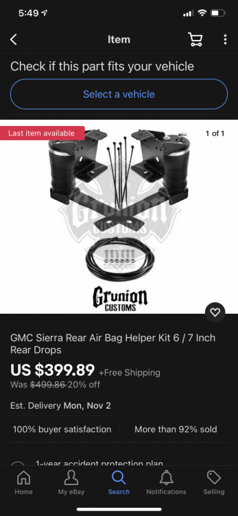

Below is similar to what I used, not the same. The attached is a better version and probably the best option before you really get into a full on bag suspension.
Thanks a lot?.  So do I need to go as low as I want to go and then use the bags only for lift? If so, what do I need to go lower? As mentioned, I already have 4” max trax springs and adjustable belltechs with shock mount relocators

I always recommend rear helper bags, it ll make your like easier.
