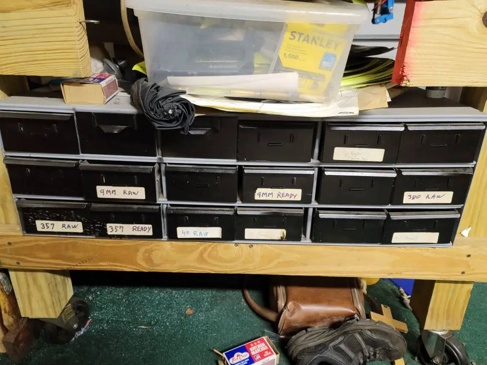

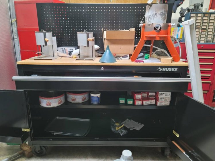

Don't worry. It can't possibly get out of control and take up lots of room.... Not pictured is my actual reloading bench (it's a mess), the stash of wheel weight ingots I made nor the 2-3k lbs of wheel weights on the side of the house waiting to be melted down.  ?20201107_004831.jpg20201107_004526.jpg20201107_004512.jpg20201107_004500.jpg
Sent from my SM-N986U1 using Tapatalk
Edited by Chevyguy85
