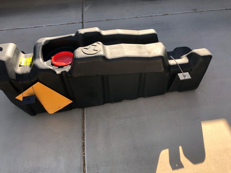

I received the replacement tank earlier this week.  The box Titan ships the tank in is about 15 inches too long.  Box was beat up pretty bad, gouges in the cardboard where the tank straps poked through and ripped the cardboard as the tank and straps slid back and forth inside the box.  The tank is plastic and was in surprisingly good condition.
I tried to do the replacement in the driveway, but I do not have the tools to disconnect the “quick connect” fuel line fittings.  I got the old tank down, but was unable to disconnect the supply and return lines.  Clearances under the truck would have made it hard to get the new tank in place under the truck, it hangs down about two inched lower, and the top sticks up higher.  Going to a diesel repair shop next week to have the tank installed, I will let you know how it goes.
The tank uses the original fuel pickup and level sender, so I expect the fuel level gauge to work as the original, just take longer to fall off the FULL mark.  I have an iDash to backup that reading.  I do expect the ‘Range’ calculation to be off in the low direction.  After all, this tank is roughly 55% larger than the original equipment, so I expect the actual ‘Range’ to be half again further than reported.  I think that is a good thing!

Photos show old and new tank installed from the driver's side, and a couple of the tank just after it came out of the box.
Only driven a couple of half tanks full so far, no problems.  I'm sure the miles to empty is off, it has not changed since going to the bigger tank.  A full tank shows about 700 miles to empty.  In 15K miles I have been averaging 18.9 MPG.  With a 36 gallon tank that's 680.4 miles.  With the larger tank it should be 1,058.4 miles.  The trucks computer is not aware of the extra fuel in the tank.  If you add about 50% to the trucks estimate, you will be closer to the truth.
