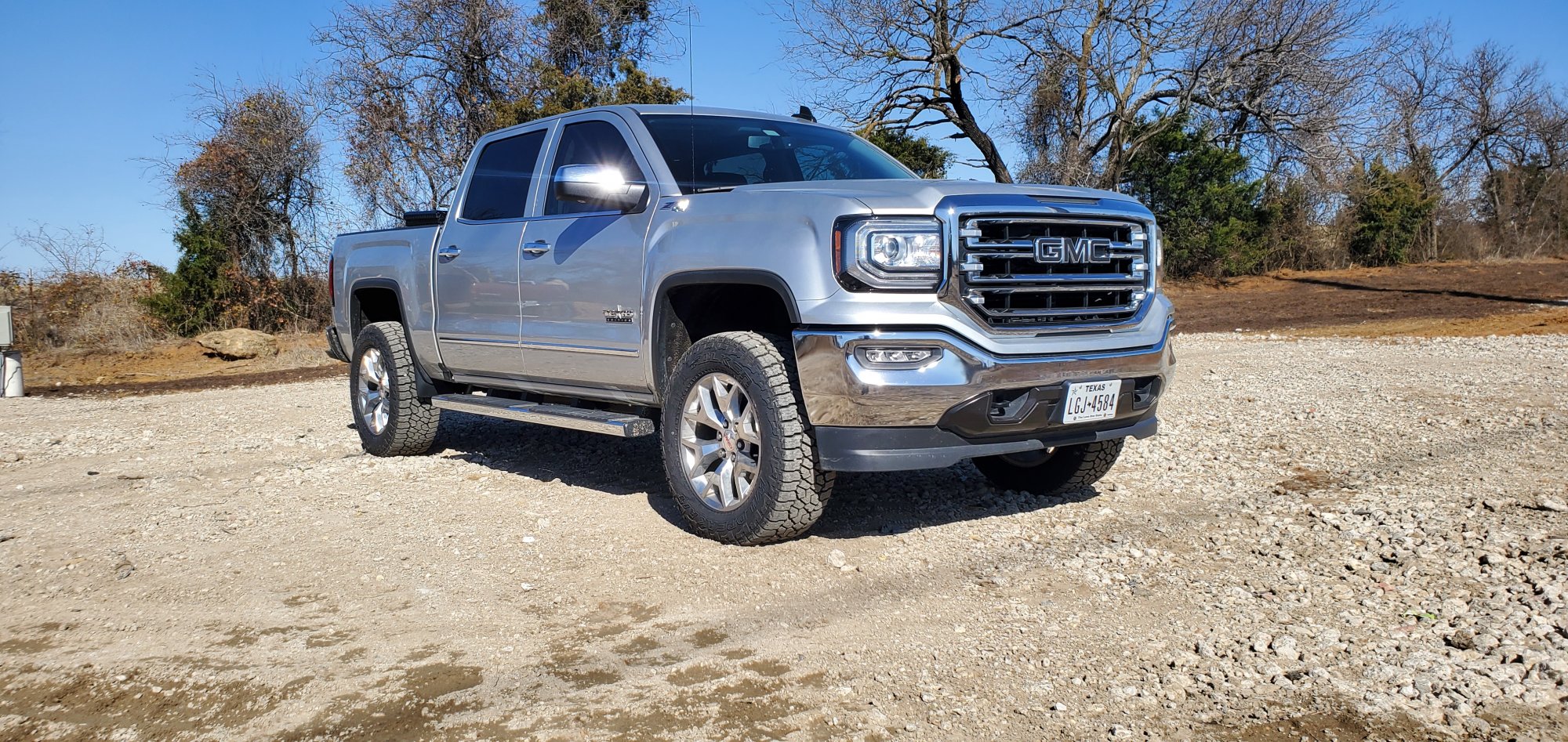

So not a Denali, but I have 3.5 of lift and 34s, on stock wheels, will give you an idea of the 4" lift size. I am right at 2k for tires, lift, and alignment.
Nice clean looking setup.  Any rubbing or trimming required to fit those?
Thanks, I like it alot. I am running 1.5" wheel spacers, so I had to trim the back side of the fender. Could have eliminated the rub with zip ties probably, but I wanted plenty of clearance so I did the norcal mod, I have over 1 inch on all sides, all steering positions now. And the factory plastic covers all signs of trimming.
Tires are 295/60R20 Falken Wildpeak AT3W
