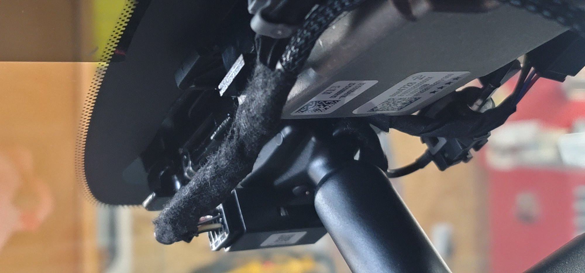

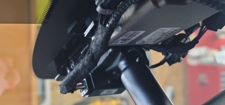

I have ever had! I found 12v in the rear view camera.
Ohh that's awesome! Got any more information about wiring it up? I'm thinking about doing that same thing for my Uniden R3. Thanks!

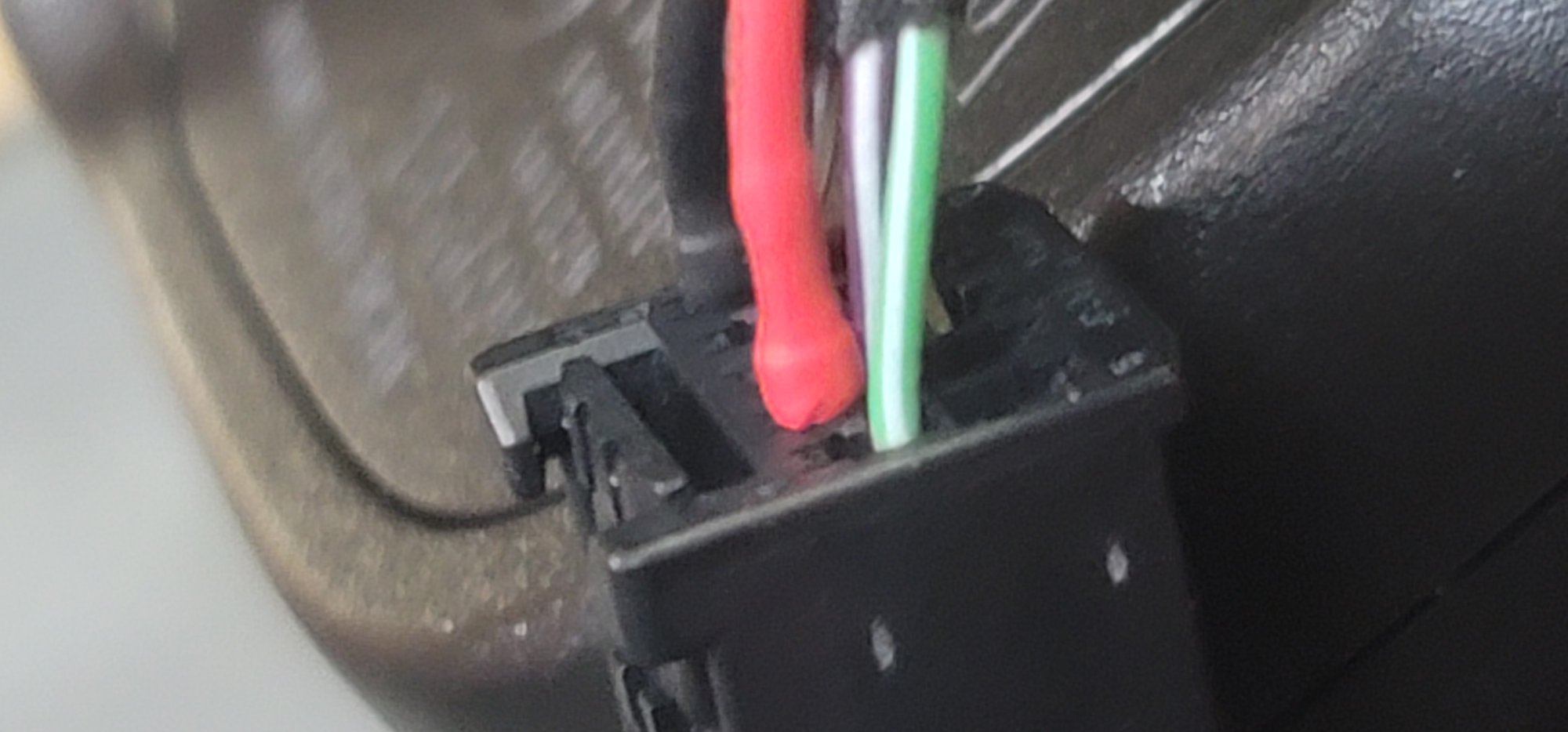

12v +/- is on the 10 pin connector that powers the camera.
Pin 6 is negative. Pin 9 is positive.
Pin 6 is the black w/white tracer wire.
Pin 9 is the purple w/white tracer wire.
This is on a 2021 GMC 1500 Denali. Your wiring might vary.
Good clean install!  Really like the windshield tint sunscreen too.  I have added that to our new vehicles for several years now.
