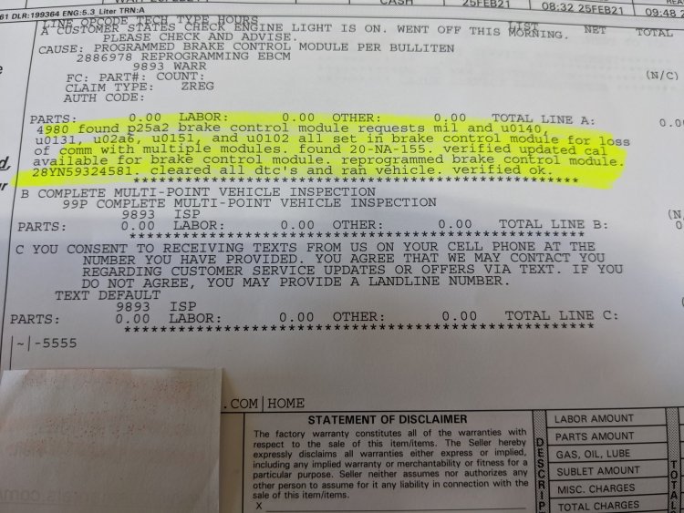

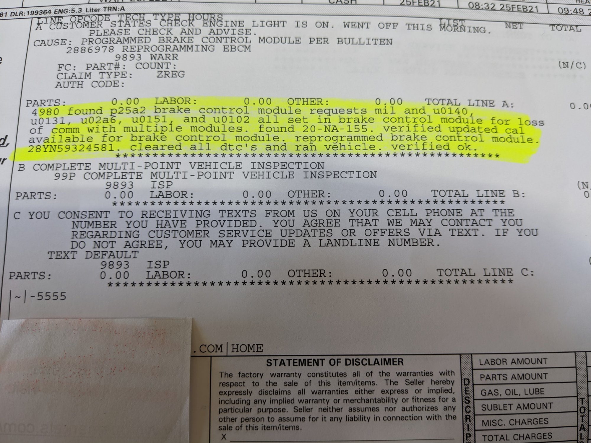

Since I have own my truck I recall a couple instances where I started the truck up put in drive and the parking brake was set. Yesterday I headed out Started it up put it in gear and the parking brake was set .  After bowling yesterday same thing only this time it was followed by a check engine light.  Took it to the dealer this morning. They read the codes, it was a Brake Controller issue. Looks like they reprogrammed  the Brake Control Module per bulletin 2886978.
