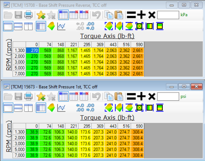

If you're unfamiliar with HP Tuners this will look a little complex to you. Here is the base pressure for reverse compared to 1st gear. As you can see it calls for ~ 8 times the pressure of 1st gear, which has the highest psi of any forward gear.

Lucas, you have one table in PSI and the other in KPA. So what you say is not as true.
If you switch to PSI for both tables they are nearly the same.

Crud! Good catch man. Considering I've never touched the reverse table that makes sense. I've played with 1-8 quite a bit and never liked KPA so I switched all of those tables over.
In any event I cut the values in half for the first two columns as a test and it feels no different. So therefore I dont think there's anything from a tuning perspective that can be done to help. But i have had the dealer flash "the latest calibration" before and then downloaded it into HPtuners and compared to before and haven't spotted any differences. So maybe their updates change something I dont have access to??
