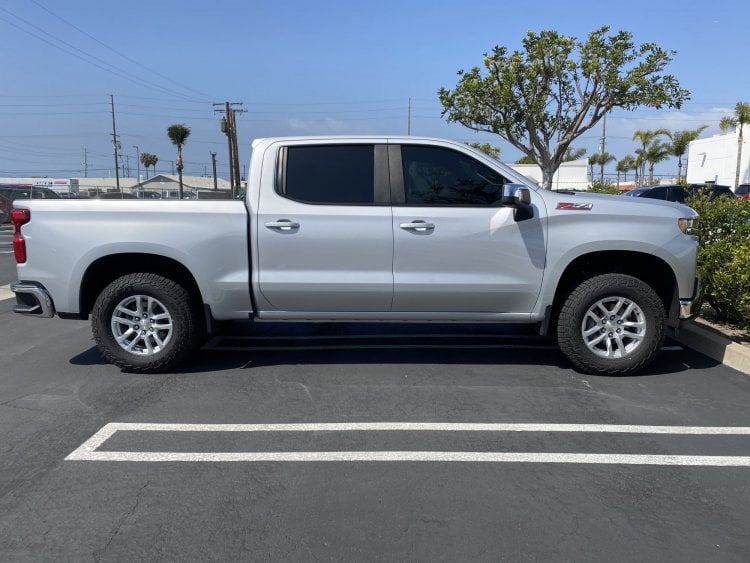

I couldn't tell you what notch it was set at for the front 293297.  Didn't do the install myself.  It is ever so slightly higher in the front, but that should all but dissipate in a few weeks once they settle.  I also did the back Bilstein 293471.  Picture attached and this was done last Friday 19MAR.
 I notice the main difference in the back with the new shocks.  Front as well but more in the back.  It was well worth doing both front/back in my eyes.  Initially I was going to do the lower spacer and quickly changed my mind after reading.   I'll take this on local trails in Big Bear so I didn't want to mess with the spacer for that main reason.
