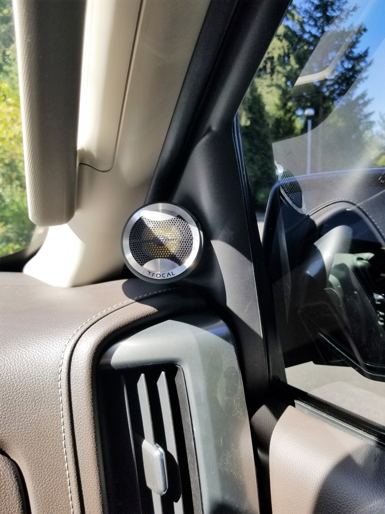

Depends on your factory setup. Dash speakers in my LTZ with Bose are a separate channel, so they don't connect to door speakers at all. If you want separates in the door (better sound), you need to find a good spott o mount the tweeters. I put mine in the door sail to make it easy to connect crossover.

That's why I mounted mine in the sail panel of the door. You only have to run the wires from the cross over up the door panel. Running them back through the door conduit to the body is exceptionally hard. Stick with component. They sound much better than leaving the tweeter down low.
I believe the other approach is to find the door wires under the dash, cut into them to hook up the crossover, then use the cut wire running to the door to power the woofer, and run the tweeter to the A pillar or the dash somewhere.
