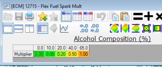

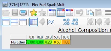

duh - now I remember reading that. something BB should be able to do is manipulate when all the timing gets added in. I've never had a single tank of e85 than was over than 80% alcohol. (maybe it's my sensor) Basically it blends the gas timing table with the flex fuel modifier based on alcohol composition. on the stock table it requires over 80% ethanol to hit that last modifier zone, I rescaled mine and it helps a lot. Look at the difference...

I’ll definitely look into that. The highest I’ve seen is 81% at the station down the street from me but I’ve been curious about throwing c85 in the mix for the fun of it. It wouldn’t be a regular thing but just curiosity I guess. Honestly you’ve been a lot of help with all this. Now tomorrow I need to do some data logging and see what a revision will do on e85 and headers

I wanted to add to this.  When I first started running E85 after adding my headers.  There was a flat spot in the crusing area when running E85.  The truck would down shift on hills that with 93 it would just hold that gear up the hill.
How I fixed it was to add 1 to 1.5 degrees of spark to those area's in the main spark table.  Then E85 table will add or subtrack from that number as they need to.  This little adjustment didn't give me any Knock on 93 but made the dead spot completely go away.  I think dailing in the rest of my tune really helped too, like lucas287 said!!!
