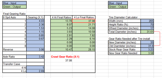

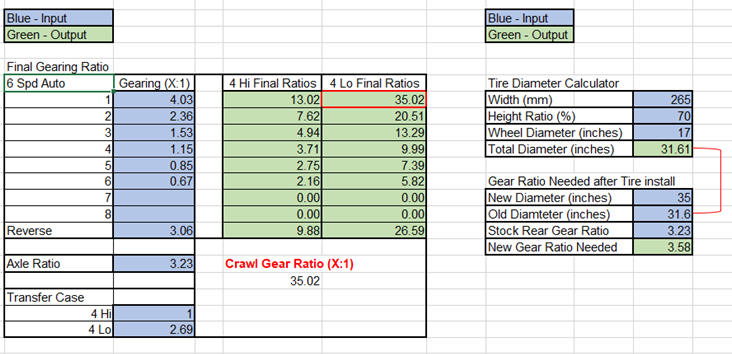

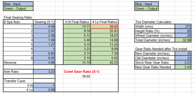

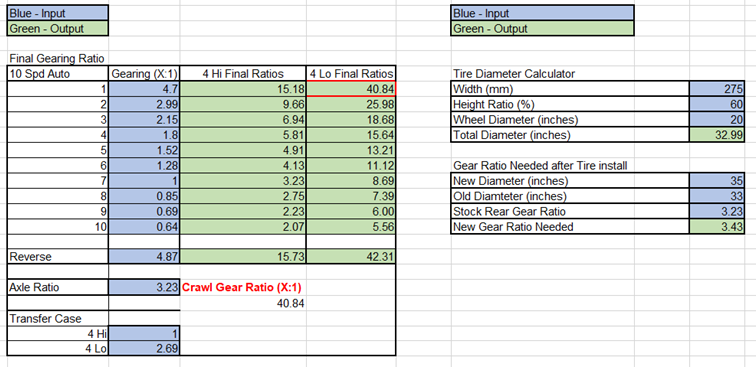

I did a spreadsheet of the final gear ratios with the 10 spd, 8 spd, 6 spd, with the 3.23's and the 6 speed with 3.42's as well.  The numbers clearly show the 10spd and 8 speed to be superior with 3.23's  to the 6 speed with 3.42's.  The 4th image is the 6 Spd with 3.42's

A good way of trying to understand the effectiveness of the 10 speed with 3.23's is to realize that you would need to be in third gear with the 6 speed and 3.42's to have comparable performance to the 10 speed in 5th gear.

Correct, and I bet it would be a blast!  Think about a single cab, SWB with that combo...fun!  With that setup, the effective final gearing would be as follows:

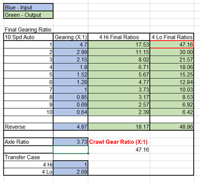

I like the spreadsheet you did there. I am an old ditch digger with limited computer skills, could you post a spreadsheet comparing the 10 speed with 3.23 gears vs the 10 speed with 3.73 gears as found in the 3.0 with the diesel off road package? Thanks
10 Speed with 3.73's:
10 Speed with 3.23's:
