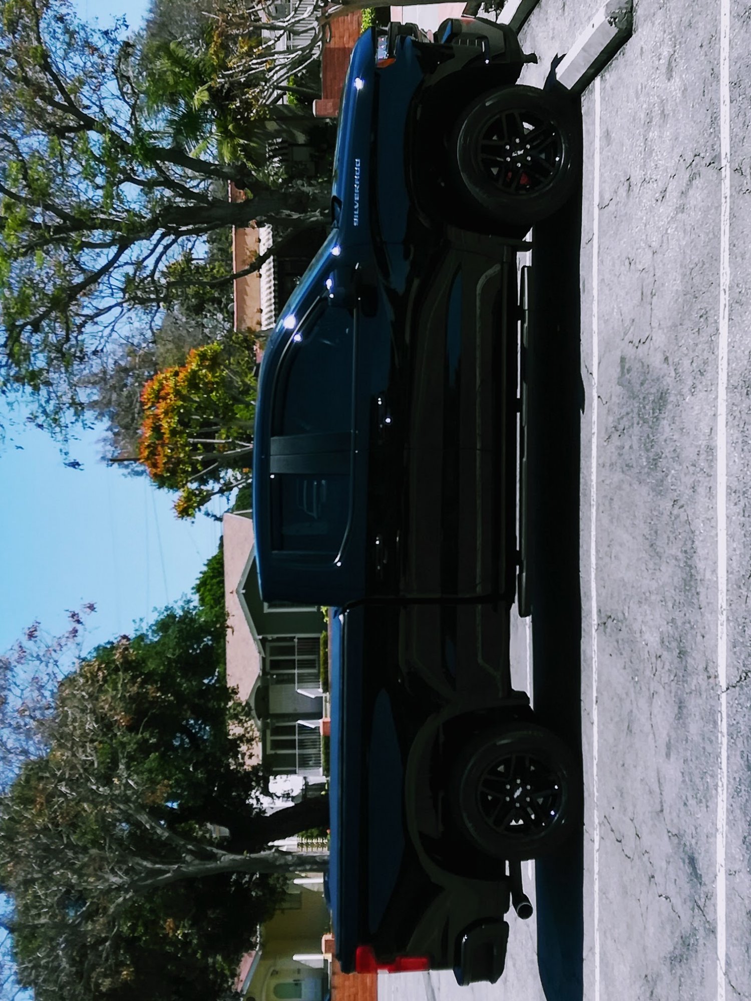

IMG_20200416_130907.thumb.jpg.a319ac76cc3d7248fae3c283b3e8430e.jpgI have a 2019 silverado 5.3 and in I had 2 bad lifters on driver be side so all lifters on that side were replaced . Truck only had 11000 miles. Dealer repaired under warranty and actually runs better than first bought. Black sunshine now has 19000 miles and runs great
