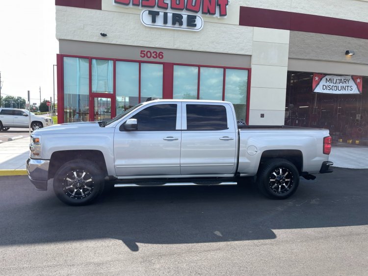

Here is a picture of the front of the truck though. I will post images of the new wheels after she gets them on. They only weight 28 lbs also :D. Dropping about 6lbs per of unsprung weight. Gotta call that a win. Forgot, that antenna is no longer there either. I got a much shorter one.
