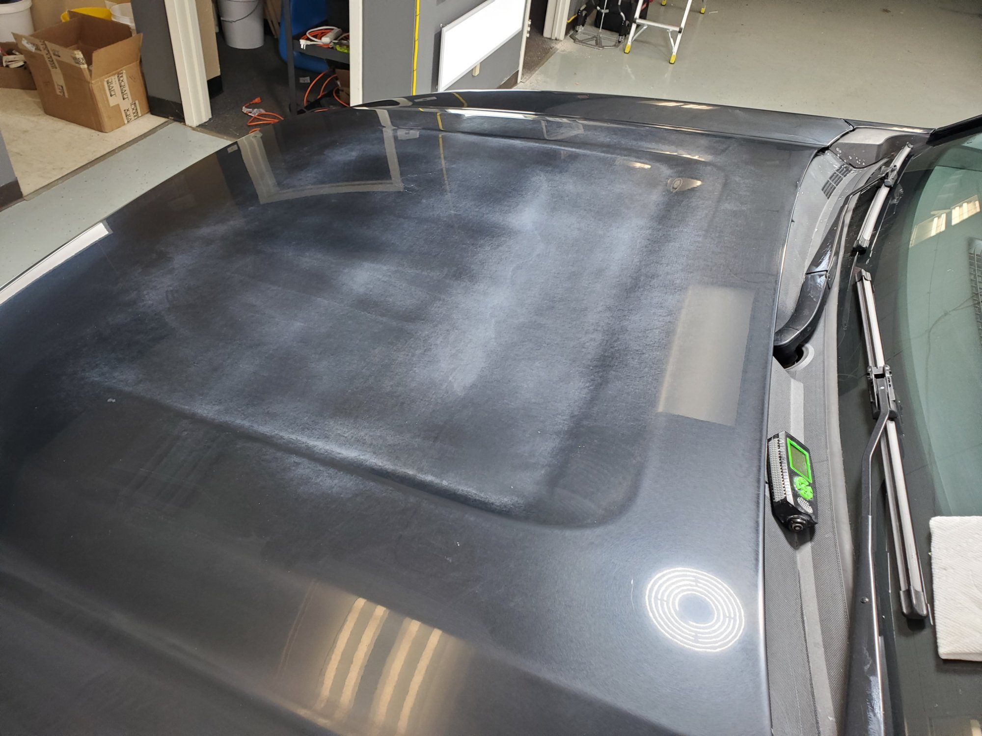

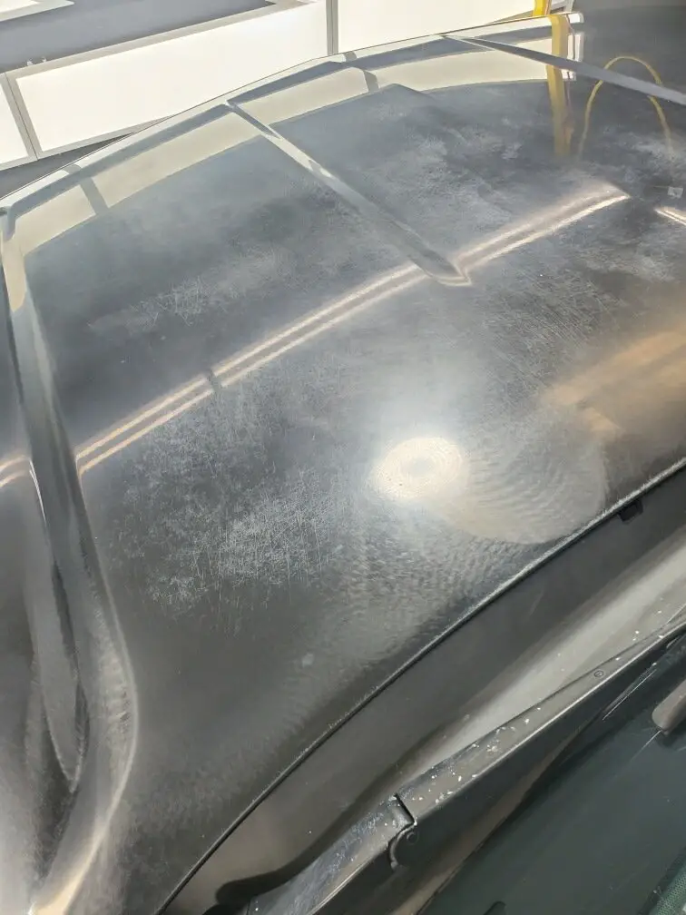

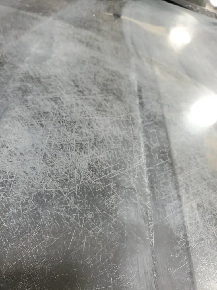

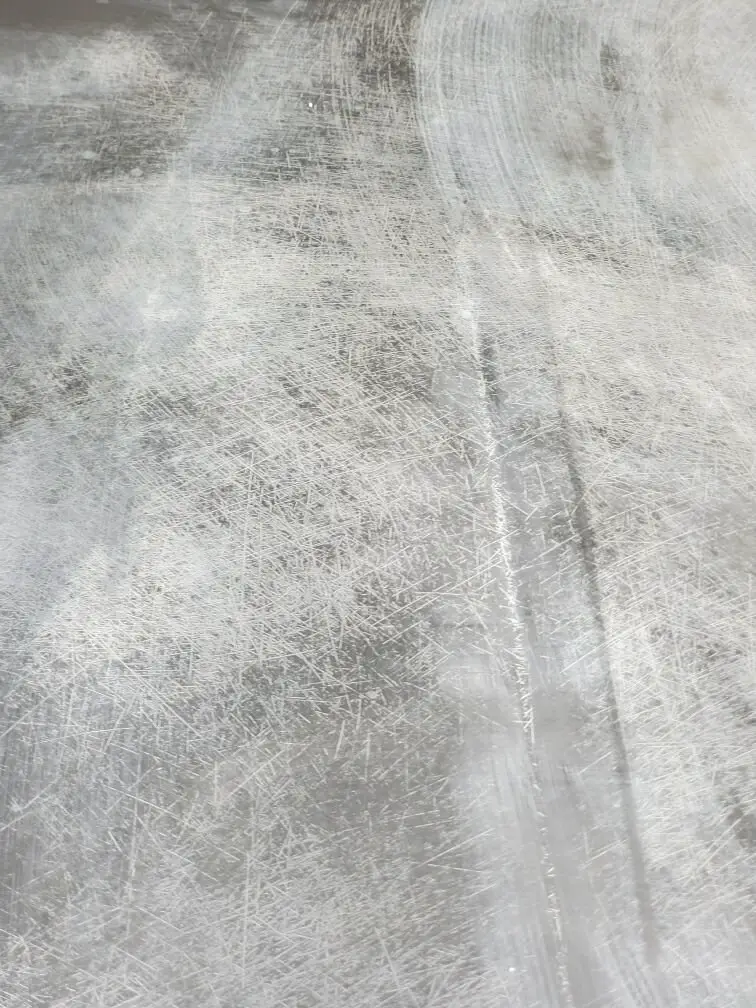

We are a local detail shop in Dallas TX (https://ceramicfx.com). This is a known issue of black GM paint (Tahoe, Yukon, Suburban, Escalade etc.). Here are some pictures from our archive. The first five are from an Escalade., and the other three are from a 2015 Yukon.

That assumption would be wrong, cost me over 2Gs to fix that crap.  That's how my vehicle looked after 3 years less than 30K miles, garaged, washed, waxed, no snow or ice.  I live on the Cali Central Coast, h**l it don't even rain.  That's definitely a defect, there is another thread on this forum about that.

I wouldn't say I have any noticeable fading yet with my 2019's black paint but on the hood and the front of the roof (where it would seem it would have gotten most of the road and wind rash) if you don't polish it you can see what appear to be lateral scratches.  I'm not sure if they are above or beneath the clear coat.  But it is only in these areas.  The side body panels seem not to be affected.  I believe the roof is steel but the hood is definitely aluminum and I am curious if this has anything to do with it.  Although when clean, polished, and buffed, it really disappears, it's not crusty or foggy like in some of these worst case scenario pictures attached in this thread.

This problem does affect the hood and roof, but the continued assumption of the cause being automatic car washes, dusty-gravely highway cruising, parking outside, or the sun is incorrect.  I've had my truck now since 2014 and this issue appeared on my truck in 2018.  My truck has been hand washed by me since I bought it (no car wash), garaged, and regular wash and wax.  This paint job is a defect whether it's with the application or materials and putting a bandaid on a defect will not fix the problem, it has to be repainted.  In my case, it went almost down to the metal.
You are correct that sanding and buffing didn't help, and unfortunately you made a mistake.  What you did sped up the process.  No assumptions, if you don't get those areas addressed by a reputable paint shop, sooner than later your truck will look worse than the photos above.
