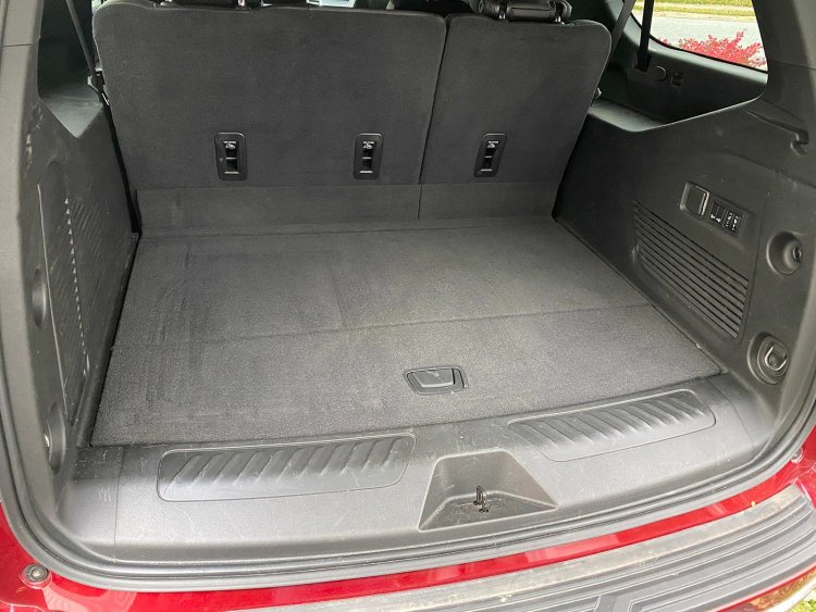

On bumpy roads, I get "clunk" sounds from the back of my 2021 Suburban.
It was particularly annoying went I drove out west this summer and drove some highways with closely spaced joints.
It was clunk after clunk.
I suspect it is the rear window but, upon inspection, I can't find anything wrong with it.
On smooth roads, it is quiet.
Anybody else experience anything like this?
  • 4 weeks later...

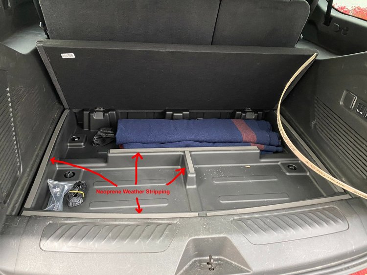

I experienced more of the clunking noise today.  Interestingly, it seems more prevalent when I have something in the back cargo area.
I am starting to think it is the hinged door over the rear cargo storage compartment that is making the noise.
I put a bunch of towels over the contact areas to see if that dampens the noise.
  • 1 month later...
Today, I used weather stripping to pad the support points for the rear storage cover.  The "thunking" is gone.
