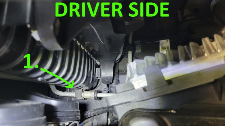

On 12/11/2021 at 12:47 PM, BlaineBug said:
Correct me if I am wrong but here are 4 lines I see running to my radiator and the condenser up front. 2019 Yukon with active aero shutters in the grille.  All 4 lines are the same quick disconnect style with the clip and plastic retainer.  Are all transmission related?  I didn't think the A/C lines used quick disconnects like these, but I'm also not sure where the engine oil cooler goes.  As far as I am aware there was an engine oil cooler.  I do not have a factory towing package, as in, no integrated trailer brake controller in the dashboard and no 2-speed transfer case (2wd, auto, 4-hi only.)

So the two big lines in your picture, those are engine oil cooler.  The two smaller ones (one on the driver one on the passenger) are for the transmission.
2019 Yukon 6 speed its trans to the aux cooler only, no connection to the radiator.  See pic below:
Yup 👍
Makes sense, I possibly recall this mentioned here before.  So the engine oil cooler is in the radiator?  I would assume engine oil would be much hotter than ~210 degree operating temperature of coolant so that makes sense, "cooling" it to somewhere around ~210 degrees from something that would normally be much higher.
Yes.  Engine oil goes to the radiator.  If you ever get the chance to watch live data, engine oil temp typically runs within 10 degrees of coolant temp at operating temperature.  Towing would raise it I'm sure a bit more, probably 220-230F.  Used to watch it in my brother's 2014 Camaro, oil was consistently 205-220 degrees, just above coolant temp at 195F.
