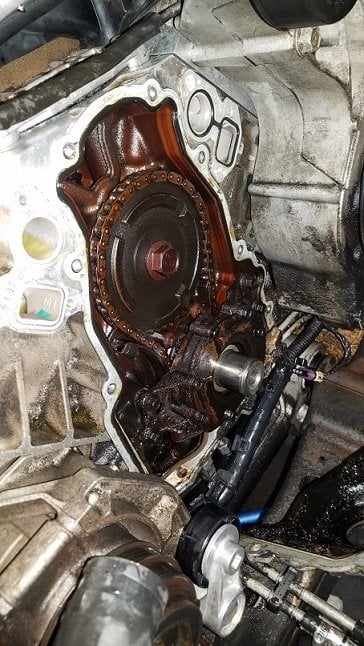

Pickup tube o-ring is bad. The oil leaks through the seal over night and results in low oil pressure on start up. The oil pump doesn't pump air very well. The longer the truck sits, the worse the problem gets. Let it sit for 3 days and you will see what I mean. Let it sit for 5 minutes, and no problem at all. Parking nose up hill or nose down hill, adding an extra quart of oil, etc etc, lots of ways to confirm the diagnosis.  When you change the o-ring, do it through the timing chain cover, and use the opposite bolt hole for the tube upon reassembly, with an aftermarket tube retaining bracket. MUST get the correct puller for the crank pulley. Once you reinstall the timing cover, start the engine to confirm that there is oil pressure. Then let it sit for a day or two and restart it again to confirm that its fixed before you reinstall the water pump. Replace the front seal while your in there. Have a nice day.
