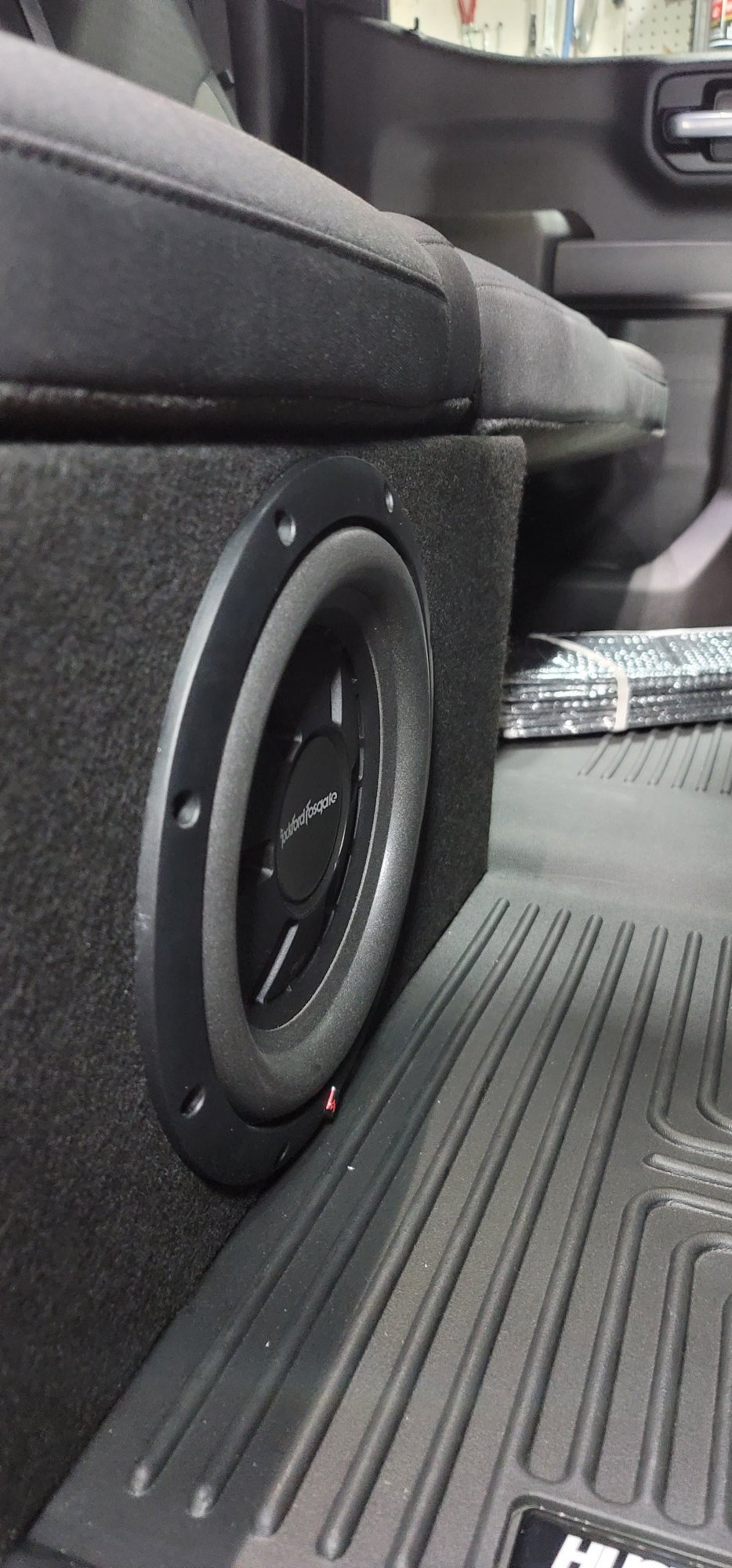

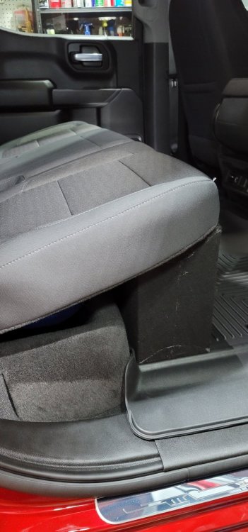

15"subs are definitely not going to fit without removing the seats. 8's and 10's will fit under the seat if you made a custom box and remove underseat cargo tray. I built my box with keeping storage space in mind. Shallow mount 10" subwoofer, hits low bass and loud enough to vibrate the seats and mirror.

As stated above, 15s wont be going under your seats or anything like that, so be prepared for some extensive mods to fit it and keep seats or remove seats.

I built a down firing box with an IDQ10. Could easily do 2 of them. 2 full size 10's with some power should sound really good and more than enough for most. My 1 10" hits pretty hard and I only have 400 watts.
