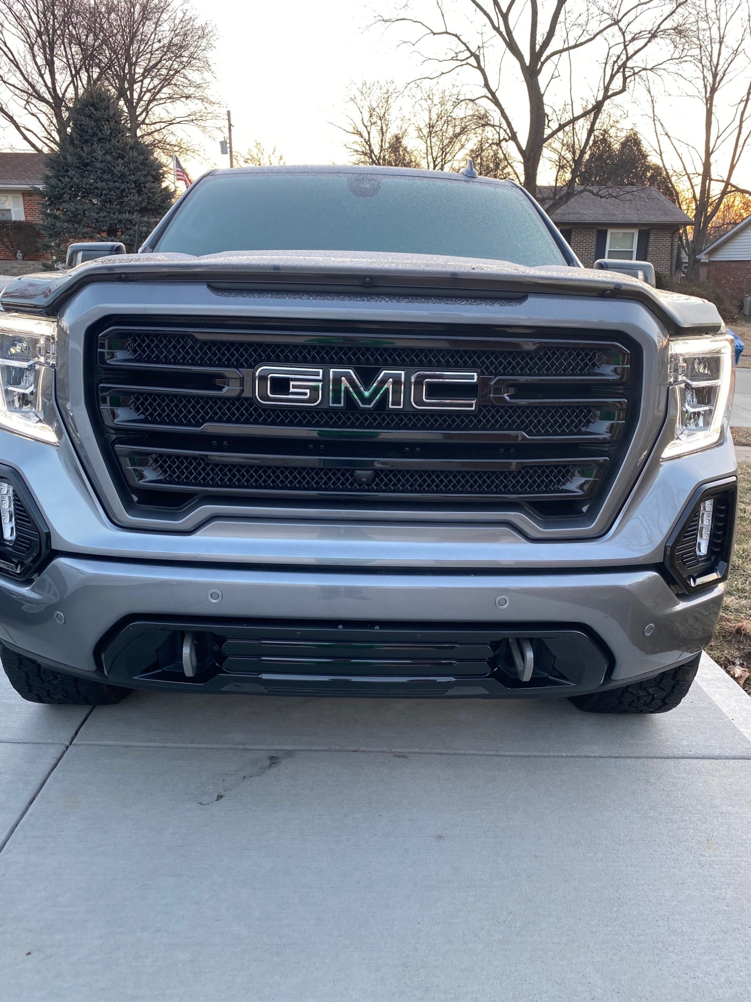

8C6E24D6-2E15-4CFE-8AA5-7B46B77A9D39.thumb.jpeg.b7dcf5bfeea53570e8e1aabd13380114.jpegI have a 2020 Sierra AT4 and where I live in Missouri we are supposed to have a front and back license plate. I don’t want to drill my front end to put one on. I went to the GMC dealer and they sold me one that’s supposed to fit my truck from the vin#. It doesn’t match up! To any of the holes. What are these holes used for? Did they sell me the wrong plate bracket? Thanks for the help! Patrick

Larger picture of front end

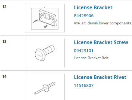

84428906 is the bracket for AT4.
Those holes look like they were plugged by someone prior to you.  Those plugs aren't factory.

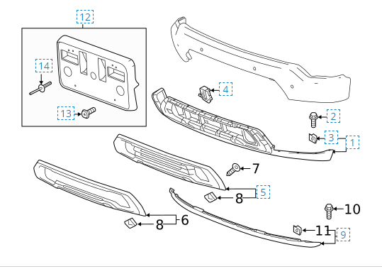

This is the diagram for the lower front bumper for the Denali and AT4

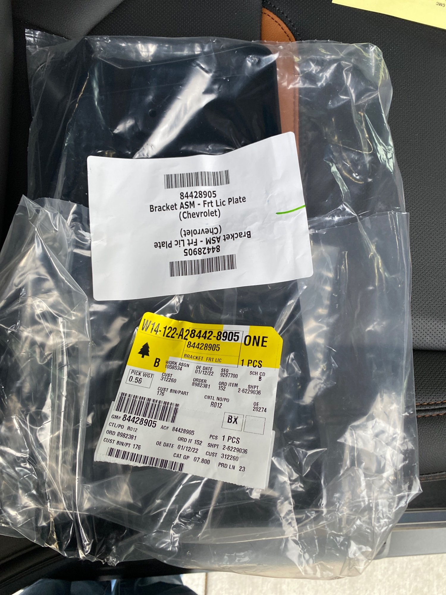

84428905 fits 2019 Silverados.  Definitely the wrong one was sold to you.  Even the packaging says Chevrolet.
Good eye! I didn’t pay attention. Damn! Thank you! I appreciate it!
If you look closely at the black trim piece under the bumper, you will see what looks like caps/plugs on the front side of the trim.  Hard to really see in the picture that is posted currently.  There was another picture that had a close up of the bumper and trim where the OP circled the holes.
3 hours ago, Transient said:
I'm on a cell phone and the pic gets worse when I zoom in
Me too and I saw what he was talking about.
