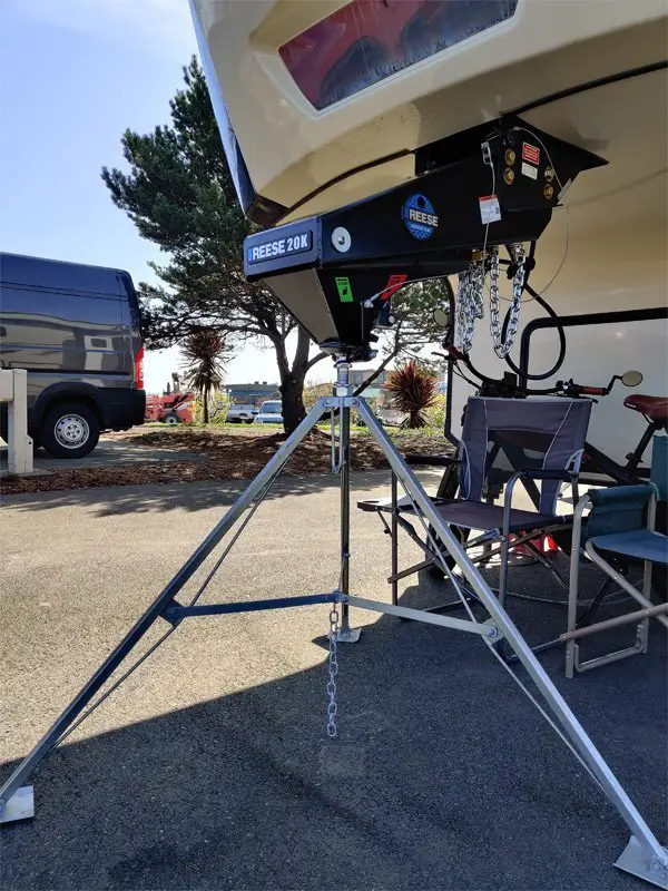

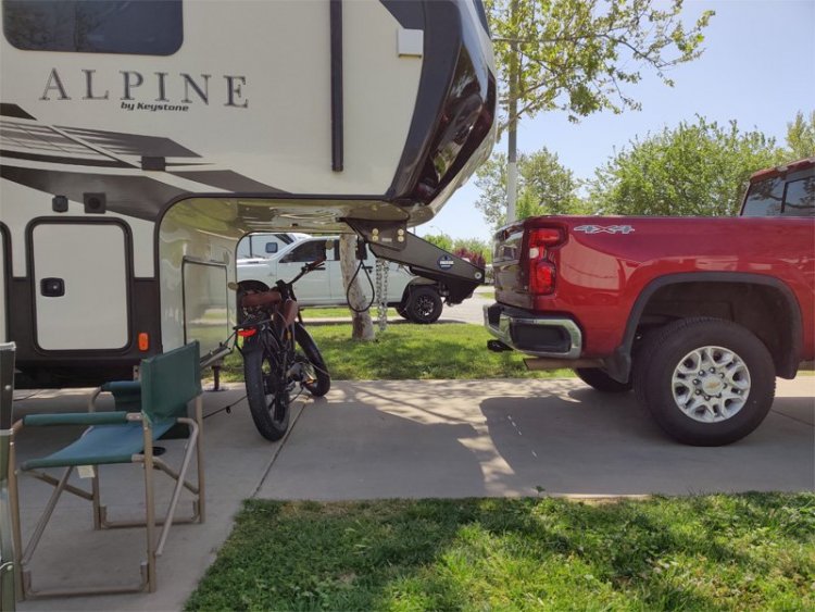

I installed a Reese Goosebox as well.  I like it after the first tow from Oregon to California Via Highway 101 (rough, winding & rougher).
In comparison to the previous setup (B&W Companion with slider hitch, Lippert Rota-Flex pin box, Dodge shortbed), I am very happy to make the change.
I'm pulling the trailer about 2-4 time per month, and need the bed at every stop.  So this seemed like the best alternative.  If I was only pulling once or twice a year, I'd opt for the B&W without the slider.  I really like how easy it the B&W is to hitch, and how connected the trailer felt when towing.
My thoughts on the differences and towing experience, so far:
Pro's over my previous B&W/Rota-Flex setup:
* Removing the Companion slider was a heavy bugger. I did not enjoy removing/installing. Especially since I was doing it by myself.
* Small foot print in the front allows a bigger chest at the front of the bed.
* Seems like the airbag in the Goosebox is less jarring on the trailer.
* Looks expensive (great for bragging rights with the "neighbors"... lol)
* Was able to get about 6-1/2" of bed to 5th wheel clearance with a pretty level trailer.
Cons:
*Lining up is a learning experience.  I'm going to make a magnetic sighting system I can see looking out the back window to make connecting easier.  Something I can toss in the bed box.  I'm not competent enough to use the bed camera to get latitudinal alignment yet.  I'm using the trailer camera, set on the wheel well to get longitudinal alignment, and that works well.
* Less room down the side of the bed for chests and stuff, because of the size of the Goosebox structure when making turns.
* The ride feels a bit disconnected, especially on rough roads through the turns.  Feels like the trailer wallows in comparison to the 5th wheel connection.
* Goosebox sits a lot lower than a standard 5th wheel pin box.  So when the 5th wheel is level, I can't back under the Goosebox (it is lower than the bed).  At short narrow camp spots, that can leave the truck hanging into the road.
* inflating the air bag, and connecting the chains/safety brake would be more difficult without the Mult-Flex tailgate.  Really glad I ordered that on the truck.
* Goosebox sticks out quite a bit further in front of the trailer than the Rota-Flex 5th wheel pinbox.  Since I can't back under the trailer when the site is level, that's a bit more difficult to park the truck.
