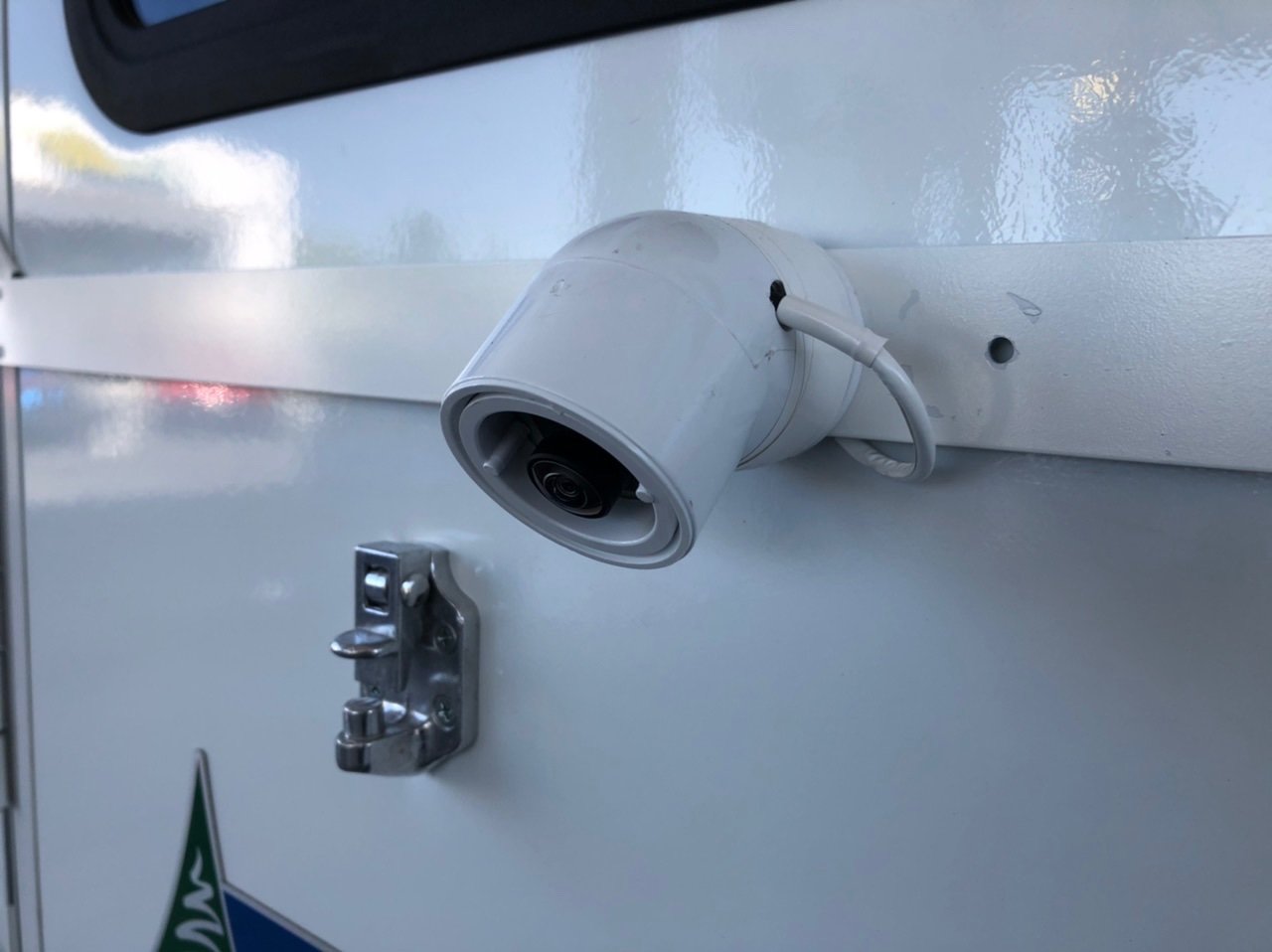

The camera gemarsh listed can be bought from an on line gm parts seller for about $100. That’s the camera I used. You can buy a cable from Pasternack.com for about $30. No need to spend the money on an entire tailgate harness that may not be long enough anyway. I can give more details about ordering the cable if you are interested. Here is my camera installation on the back of my camper. With it tilted 45 degrees down in that pvc ell, the view is identical to the tailgate camera view.
