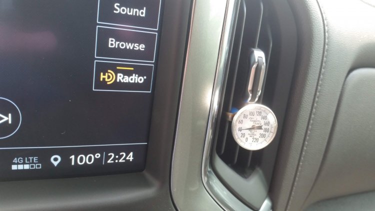

Purchased a couple of years ago and the AC has never been good. What is the correct temperature blowing out of the vents? Recirculating or not?

My 2019 RST was 39-40° out the vent. Haven't checked my 2022 yet but it's cold. Have you checked yours?

6 minutes ago, Mangano said:
41-42 degrees.   Guess that would be OK.
There really is no "spec" but if you are getting that out of the vents, it sounds like its working properly.
Edited by newdude
Check it with the fan speed on low.
34 minutes ago, Mangano said:
I'll do that.  Thanks for the reply.
Be sure your thermometer is calibrated.
